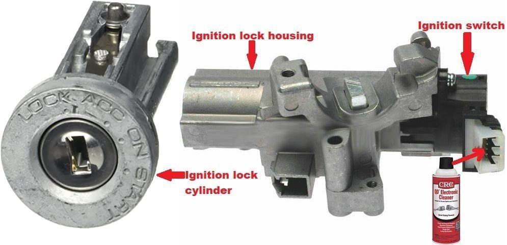

Old Nov 3, 2024 | 10:35 AM
H3s do not have locking steering wheels.
Replace the ignition switch. It doe not require a new key since you will use the original lock cylinder. You could take out the switch and try cleaning it with CRC Electronics Cleaner if there is built up crud in/on the lock cylinder.
Pic courtesy of hummer
great info! Thank you.
