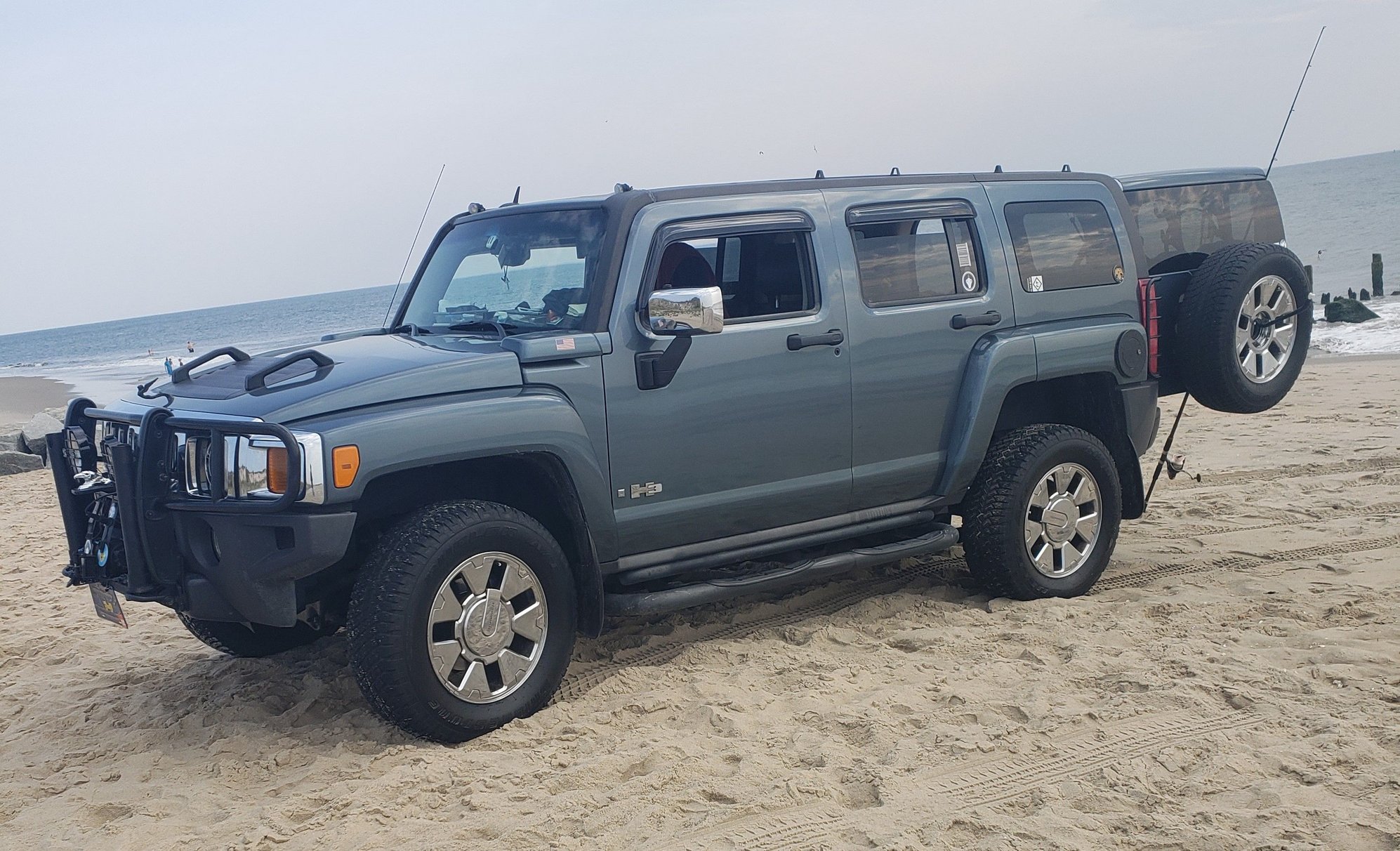

Welcome buddy...
Glad I got the 2 replacements from amazon for about $16.
The tailgate switch failed after my last trip surf fishing. (Salt water corrosion) So I replaced that one for the win.
