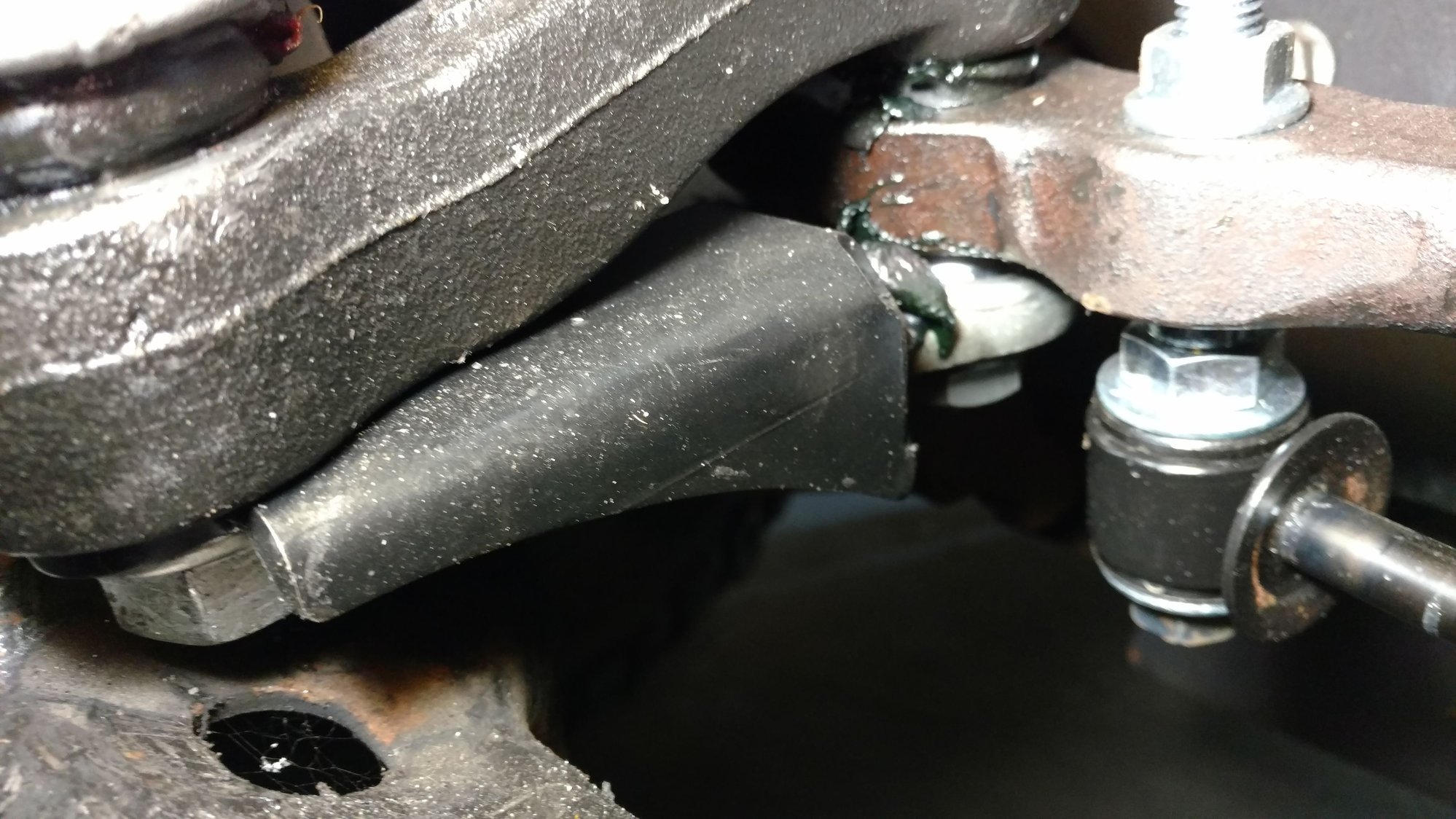

I replaced the idler arm with a Moog. Added the Cognito PISK. I installed the pitman Cognito brace first. This was a mistake. The idler had very minimal clearance requiring the idler bearing to be removed. With the pitman already braced, it was a bit of a wrestle getting the idler side together and installed.
The Moog idler grease hose I purchased had to be installed last. It could not be bent under the mounting braket while trying to get the assembled idler/bearing/PISK into the mount. Tapeing a steel rod to it so it would stick straight up into the engine bay was the only way I could get it started on the fitting. Completely blind operation trying to get the hose pipe thread started into the pre-installed 90 degree fitting.
Cognito PISK on H2 pitman arm
Cognito PISK Idler arm brace H2. Cannot be installed in the truck. Pre-assembles idler bearing, idler arm and bracket.
