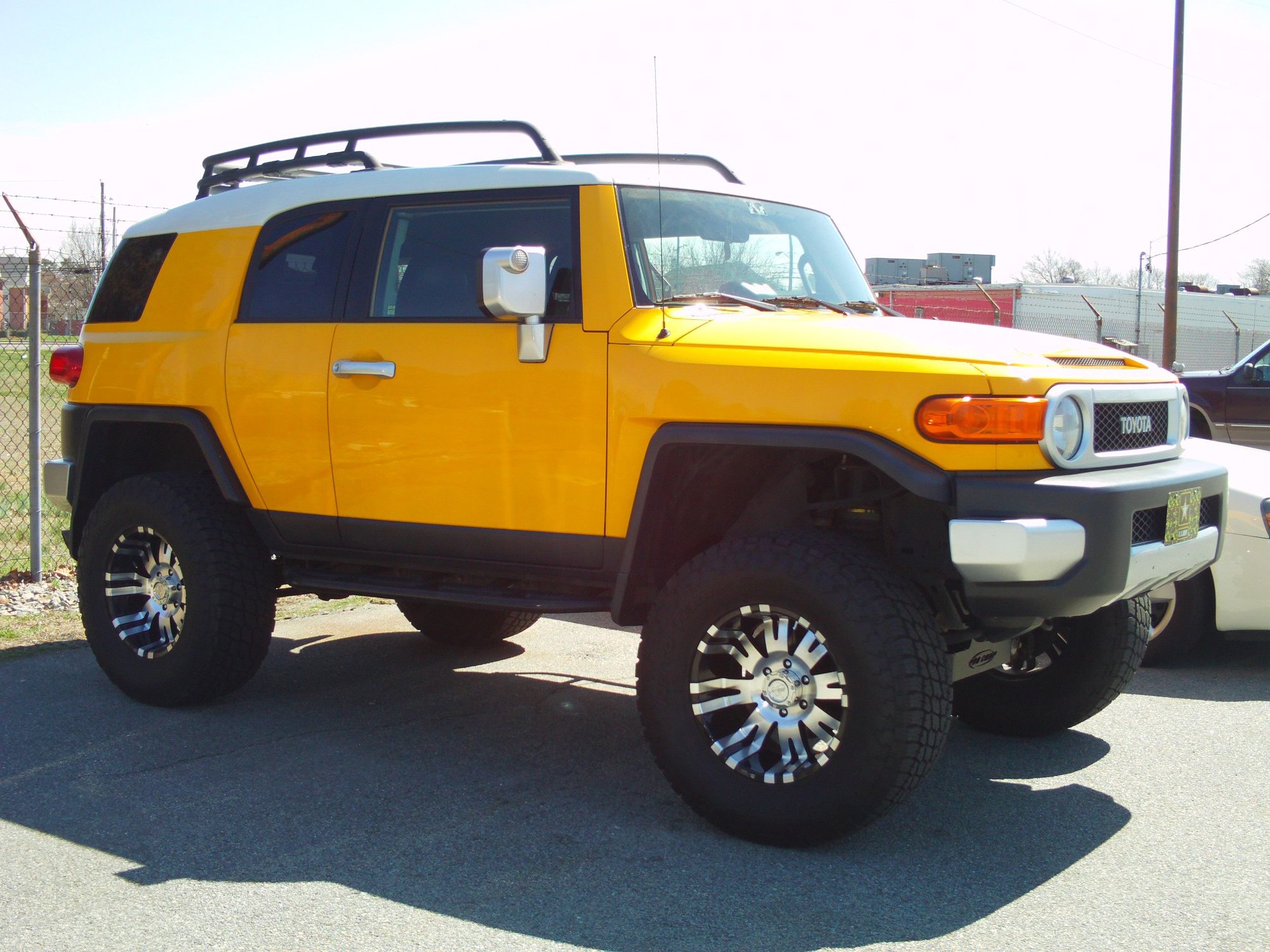

Thanks. I appreciate the feedback. I just don't want to go too big of a tire to the point where I adversely affect the transmission. I made a similar mistake when I lifted a FJ Cruiser over a decade ago. I put 35's on her, which caused the tranny to steady hunt for gears, even on flat road surfaces.
