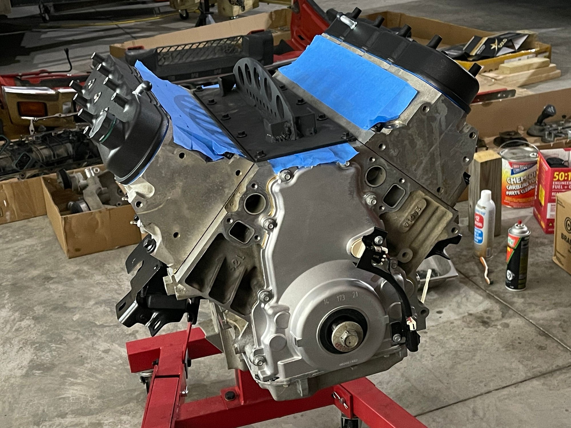

Default 140k miles worth of cleaning
I rebuilt my 2009 6.2 with many new parts, all bearings, seals. It is rect port so I can’t speak to performance you should expect on yours but I also did my own tuning so I’m squeezing out all I can from mine. Biggest problem I had was keeping any semblance of a budget because as I got into it I found that things needed to be replaced to make the build work. I reused pistons, rods, and rings, and rockers but got new trunions, push rods, lifters, springs, keepers. Reused valves too. All gaskets got replaced, also swapped to non VVT cam gears and other things needed for that. The most important thing is tuning in my opinion but I had the hardware and software to do that already. I think I spent around 4k all told including lots of cleaning supplies to make it all like new. Best of luck to you.

Drives quick and effortlessly. Very different than stock, feels lightweight on the road now. It never had DOD being a L9H engine but I did remove the VVT so less complicated now. It idles just a tad rough but not annoying. That is just a small price to pay for the power.
The motor was pretty dirty and original cam bearings were shot so I also replaced all bottom end bearings and it was worth it to do as they were a little loose, especially number 1 and 3 main bearings. Not much more to do the lower end if things are already apart.
