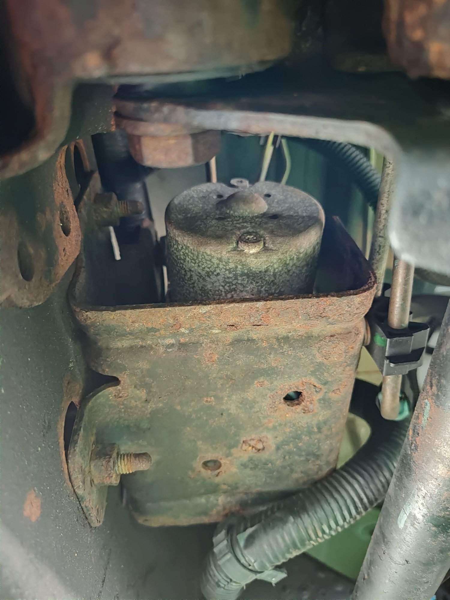

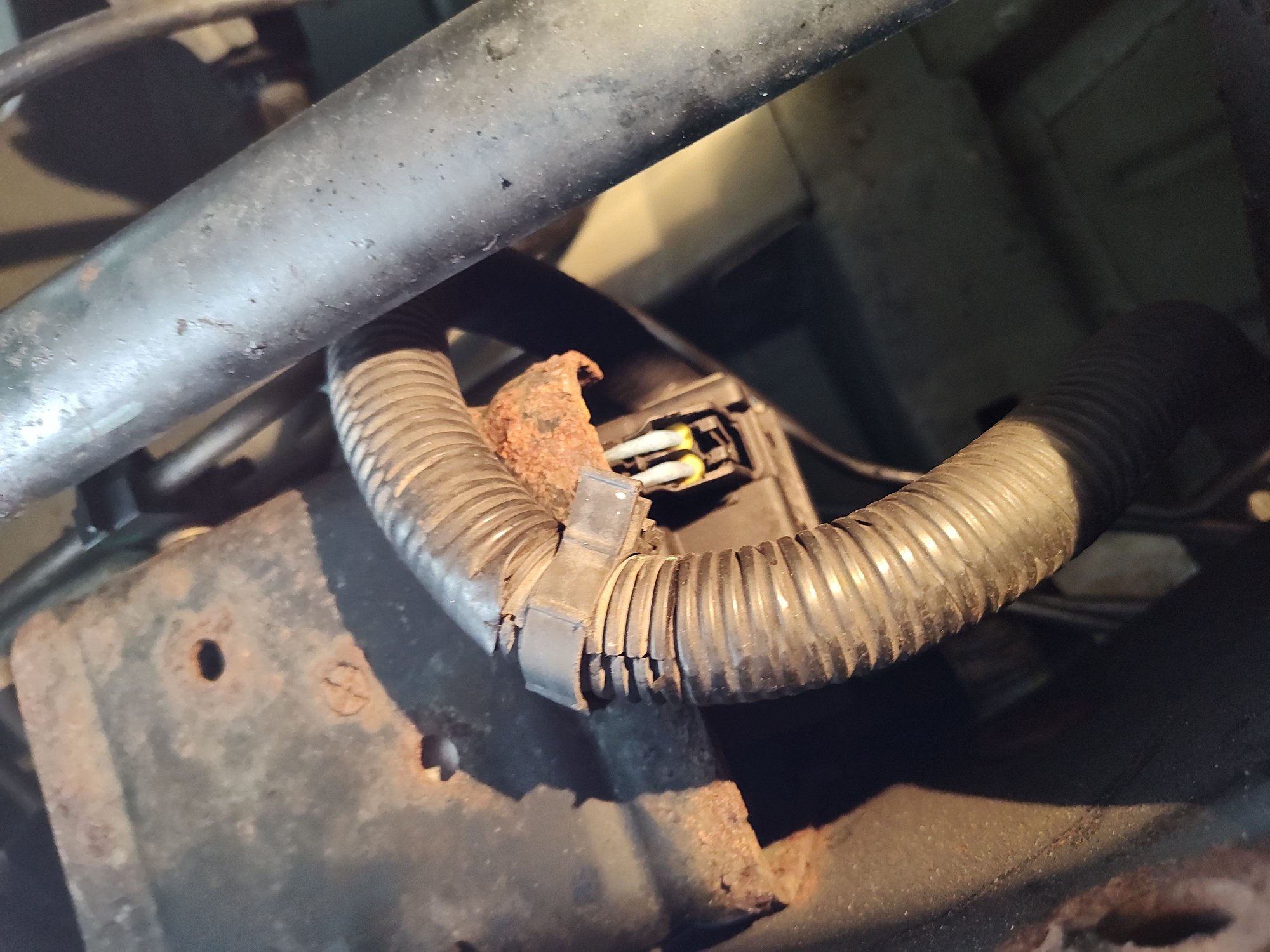

2003 H2. So started crawling around underneath yesterday (pulling skid plate to paint, then found some drips) and thought I'd check to see if I could find the purported external fuel filter to see what it looked like. I found the charcoal canister and purge valve, kept going forward and found the pictured item attached to the frame under drivers floor area. It looks like the back end of a motor but can't see the front end - just a couple wires on a block. Anyone know what I'm looking at here? It's my understanding the fuel pump is in the tank, but perhaps I'm wrong.
Old Jan 23, 2024 | 04:17 PM
Posts: 9,017
ABS pump/module by Bosch

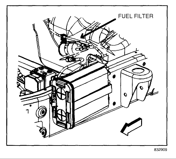

Ahhhh, ok. Thanks! Any idea where the so-called external fuel filter is or what it looks like? Was my understanding they were external on the 03's, and I didn't see one, but I may have just missed it. Or perhaps some 03's are internal?

next to the gas tank

Thank you. I didn't look up into that area. Appreciate the help & pic.
