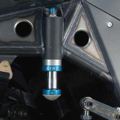

It still kills me the front bump stops are part of the ride quality.
I wish I could weld, I'd install these as a "better" option:
