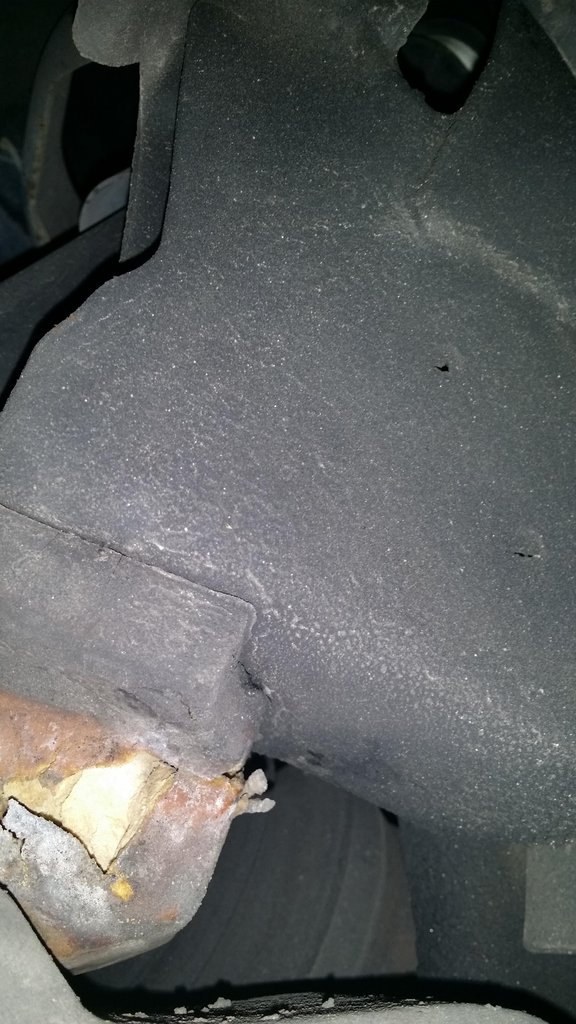

Thanks. I figured as much!
Take a look at how bad the driver's side one is!
Front

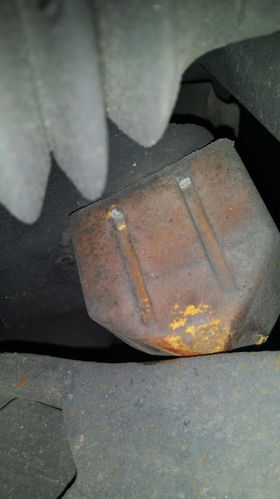

Rear

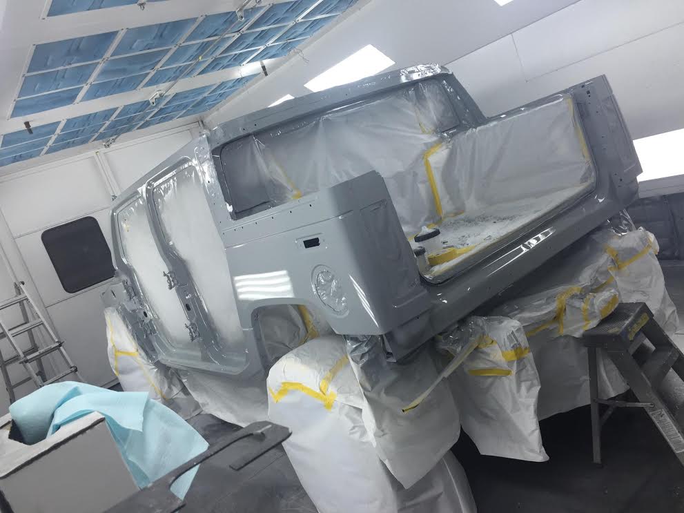

Painted mine 2016 ford avalanche grey dr-ppg
Attached Thumbnails What have you done to your h2 today?-avalanche-grey-2016.jpg

Do you have a lift or are looking into a lift? If not, then the best ones for you are the OEM bump stops. GM part #15835667.

I ordered OEM.
I couldn't find info on the length of the stock bump stops & I didn't want to take any chances. The stock design seem to be more progressive then the other round version seen on other SUVs/Trucks.
Does anyone have the part number for the rear?
Mine look good, but it might just be worth swapping them out.
Actually, I wonder how you swap them out. i don't see an accessible bolt/nut anywhere.

I'm not 100% sure but I believe the part numbers are as follows:
15062871 w/ off road package
15057984 withOUT off road package
They are a simple snap fit. So, you just pop them out and pop them in.
