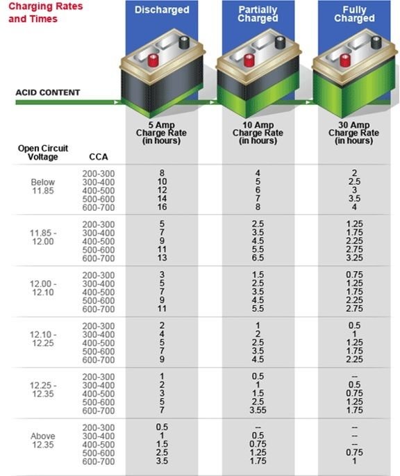

I use a 2amp/10amp charger for my battery, and If I see resting voltage drop to 12.3v, a 2amp charge rate will fully charge overnight, and a 10amp charge rate within a few hours. Here's a guide on how long it takes to fully charge (it's recommended to max at a 10amp charge rate, to avoid damage to the battery)
