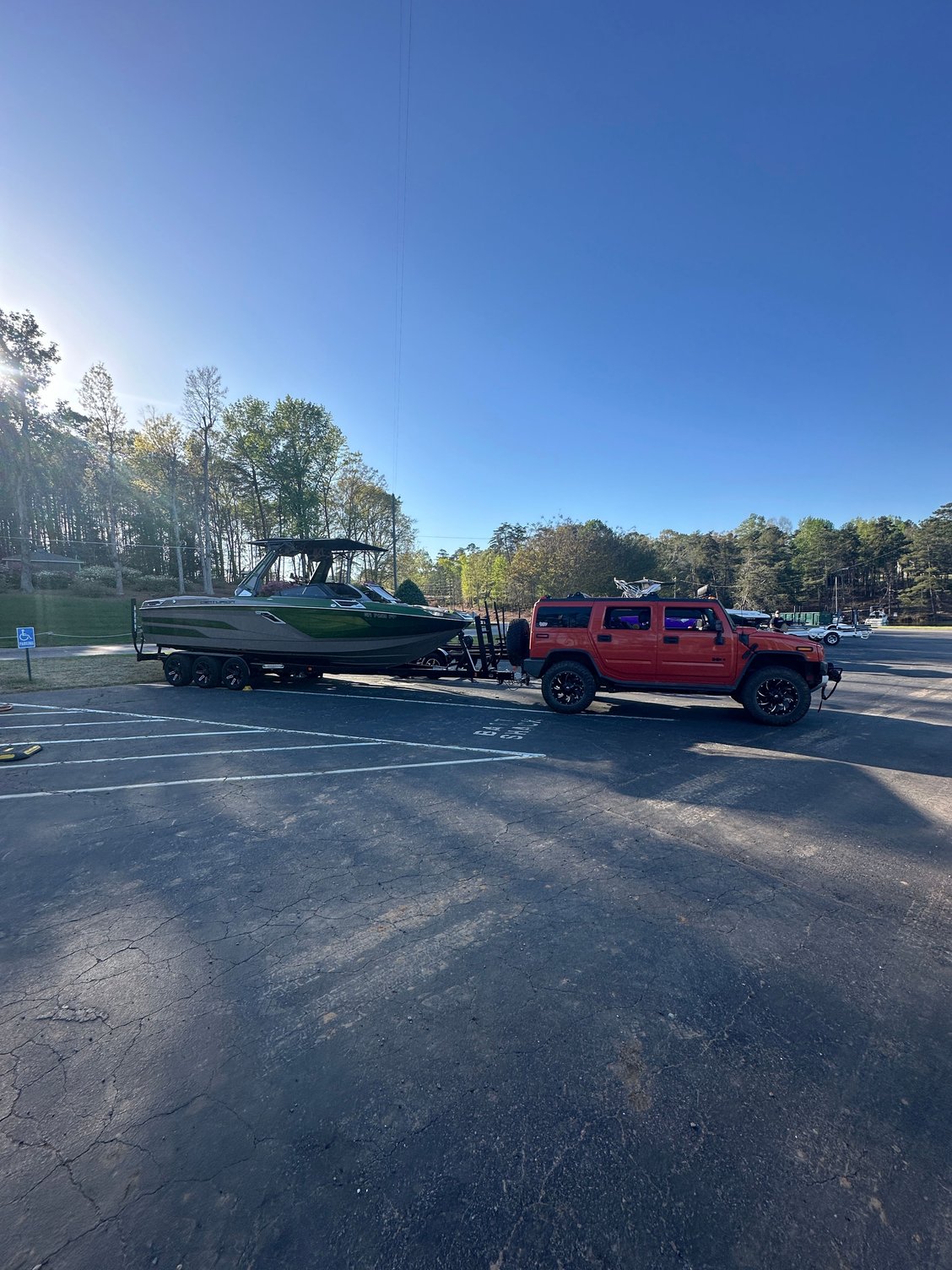

Also for anyone wondering how well an 08 with a magnacharger tows. The answer is really well. We towed a 9000lb boat and trailer up and down the hills around lake Lanier with heavy traffic in some places. It had plenty of power and felt surprisingly confidence inspiring. I didn’t use a weight distributing hitch and the truck didn’t even really squat. It was about 75-80 degrees out and trans temps never climbed above 180 with the trucool 40k installed. There’s no way the truck would’ve done it with the stock cooler.
Overall im pretty impressed. It did way better than my mom’s f150 the last time we had to tow a boat. I guess there’s really no replacement for displacement!
