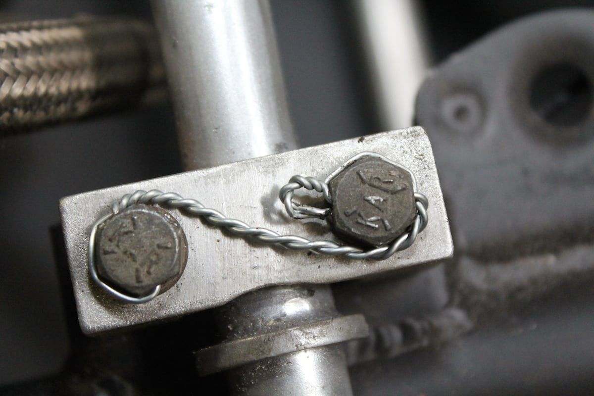

And if you really get desperate, from back in my Air Force days working on the F-15 D.... We used fasteners that had a small hole drilled.... Such as through one side of the nut, threaded safety wire through it and twisted four twists per inch and secured it to another bolt or nut that was also prepared for safety wire.... Lol, I've actually considered doing this on the valley plate cover to keep with the image of the Hummer
Actually a bad example, too many twists per inch weakens the wire, but you get the idea.
