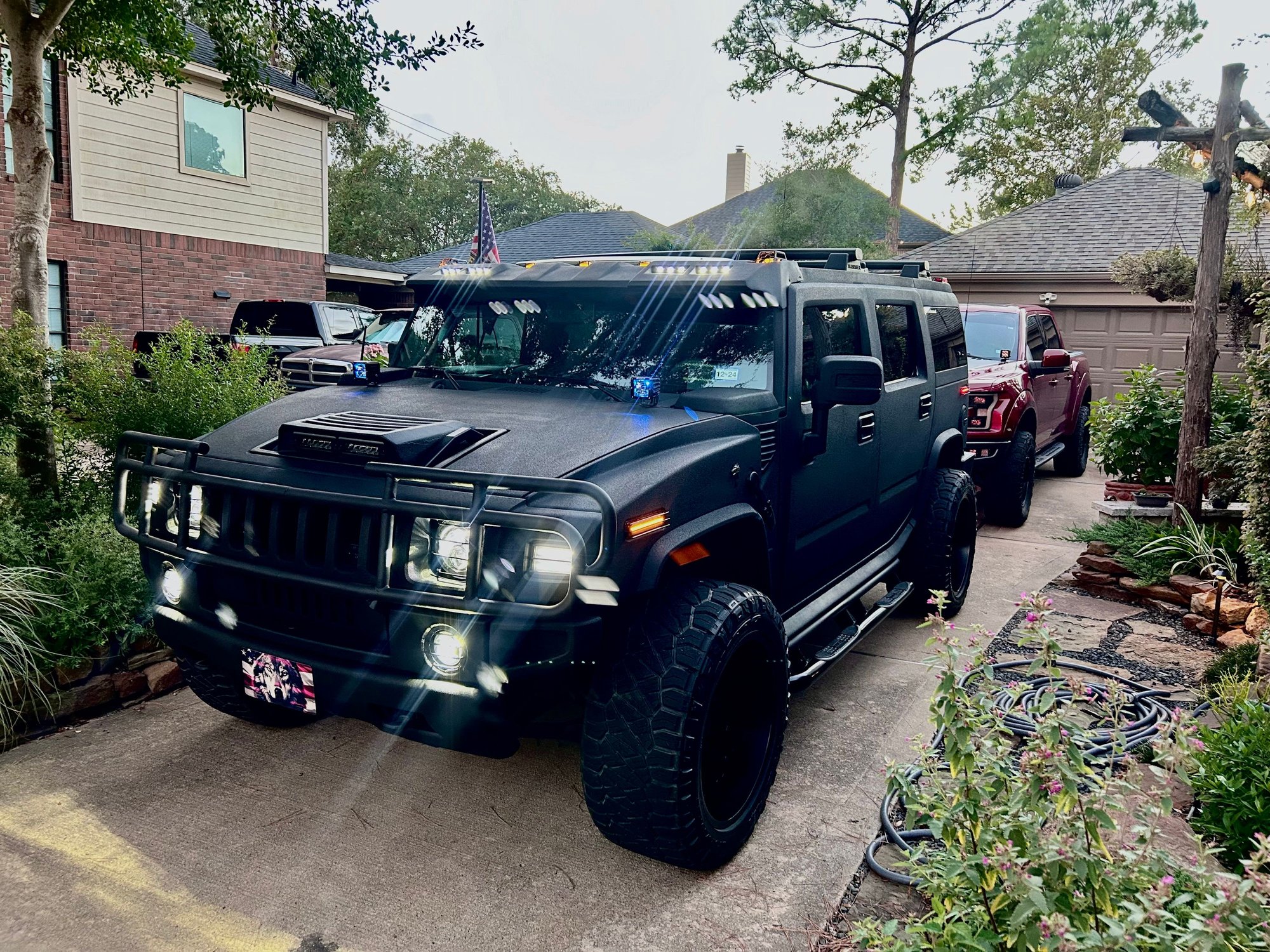

The H2 is going the distance but in height.
A LCS here quoted out a lift kit for my H2 and there were only two made as of today, a 7” lift and a 6” lift.
I just want a 3” to 4” lift as I don’t need much as my new tires are rubbing just a little when backing up.
Now if I have to go 6” so be it but I haven’t checked with you guys yet if there is a 3” to max 4”
kit in the land of H2’s.
Oh, 2008 H2 SUV, 77k miles,

As for lifts, I would suggest just getting a 3 inch lift kit, which is spacer pucks for the rear springs, 3 inch key lift for the front, new pads for the rear pucks, and new longer travel shock all the way around. Easy to install, cheap and does the job.
I have 38s on one of my H2 with the same lift setup.
It looks great and the ride is great too

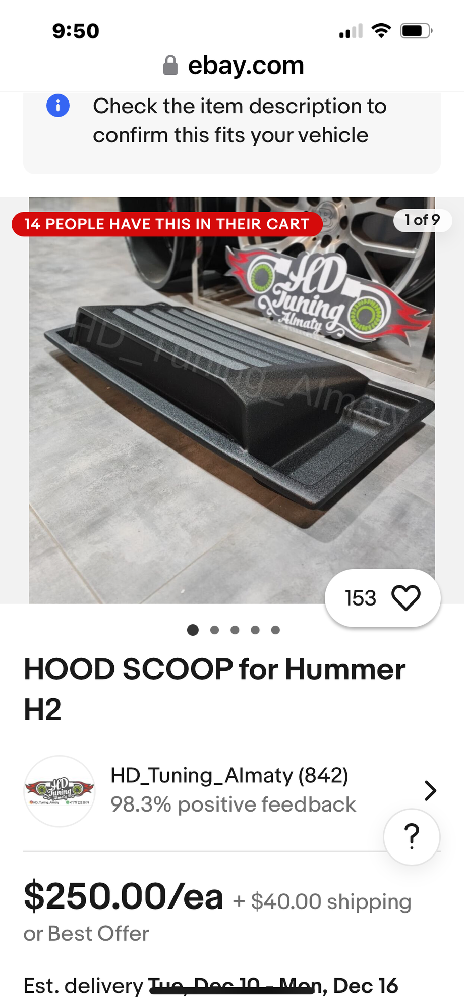

*** side question for you, where did you get the raised hood vent? That thing is pretty killer.

As far of the hood scoop I got it on eBay, took about a month to get here but that gave me time as what LEDs to use as I didn’t want to have China LEDs that will leak, collect moisture or be brighter than they say as only 300 lumens are street legal.
