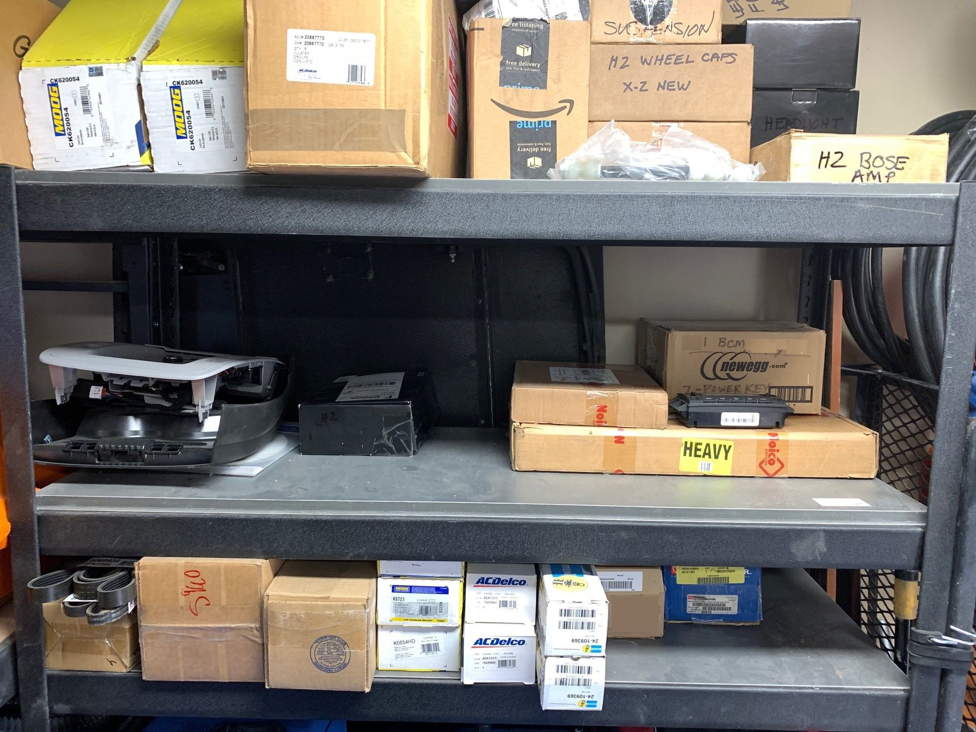

When I bought my 08 H2 I started collecting parts because more of the good parts manufactures were having more stuff made in China and the prices were also starting to edge up.
At the time I purchase CK620054 Moog upper control arms (for all H2 years) and Moog ball joints for the lowers. I looked a Kryptonite and as nice as they are I just not could not justify the cost. If I was going to do some heavy duty off-roading I probably would have sprung for them. These control arms are the Heavy Duty Moog's.
With the exception of the CV half shafts I have 100% of everything required to rebuild the front end down the road when it becomes necessary. Mostly Moog or Genuine GM parts.
