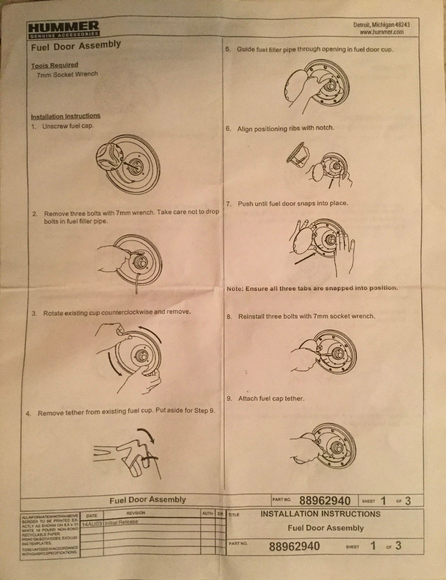

Recently replaced my fuel door assembly on my 07 H2 with a NOS unit. Thought I would pass on the GM instructions as even though it is a very simple task the instructions help.

Thanks. Had to help someone do that via txt msgs recently. Would have been handy to have those instructions to help him out. Great post.
