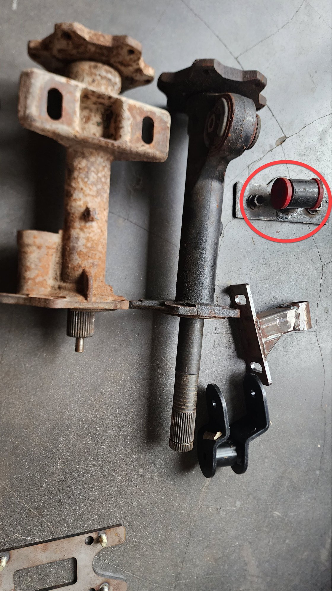

I'm currently doing my 5th Duramax/Allison conversion with LBZ (best for 03-07 H2's conversions) and can shed some light on your post. My 4th conversion (i still own/drive) retains the AWD (first of it's kind, I believe) and it's on 3.73 gears, also a fist I believe. All previous conversions, I used the 2500HD doner transfer case and was a 2WD switchable to 4H and 4L. (Me personally prefer AWD).
Had he been better informed, he could have saved time and money by keeping his front differential, which is already 3.73 on the 08-09 h2's, and only bought passenger side of clam shell diff case that has mount for actuator, retain passenger H2 axle housing.
Because I've not yet done an 08-09 conversion GMT900 Platform (I have an 08 next in line) so I can't be 100% certain but believe it follows same principles as the 03-07 I've done.
That said, From the 2500HD, he would need the TCCM and switches then rewire both and include front actuator, he should be good to go. There would be no need to program the BCM and I'm not sure that is even possible.
Error: in my tutorial, I was thinking of my last conversion where I kept AWD. To switch to 2WD option, the axle tube that is necessary is NOT the H2's but rather the 2500's. You will need to adapt the axle tube mount to fit the H2's frame mount. A very bad example is the one circled. I paid someone who claimed they knew how to do a H2 Duramax swap way back, when I was doing my first conversion. If your H2's passenger side diff clam shell does not have the hole drilled for actuator, you will either drill it or buy one that does. I've only seen 1 H2 diff without the hole. I can include a picture once I get to that part on my current conversion, if any interest.
