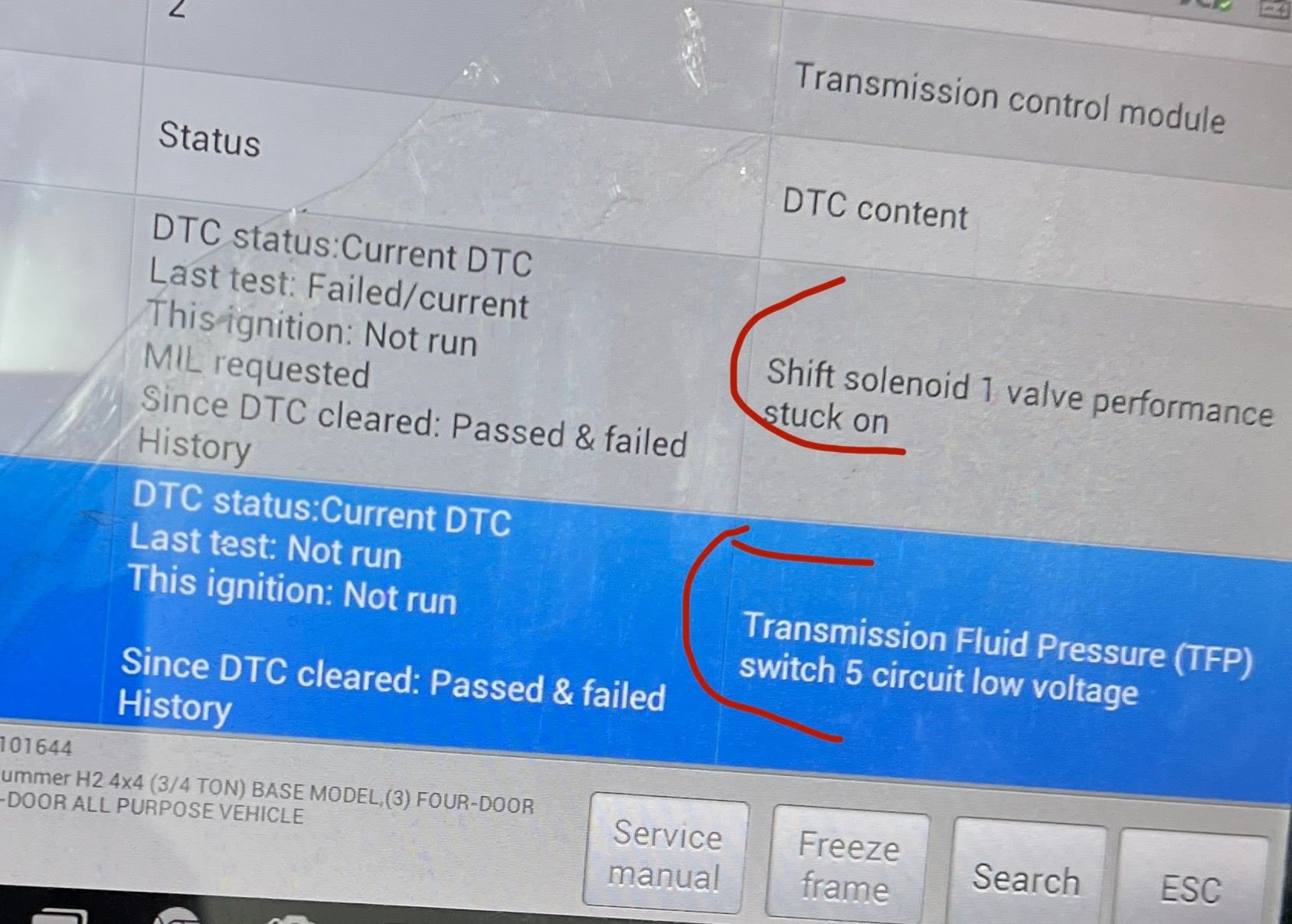

Hello,
the gearbox hold on the 1st gear and when I turn it off and on it shifts normally and after minutes back to the same problem again (H2 6.2 2008 6speed)

If you have a GM Tech2 tool you should be able to test the actuation of the solenoid. BTW, when was the last fluid/filter replacement? A clogged up filter that causes low line pressure can cause a bunch of issues for the 6L80.
Will test it ,I changed the body valve tcu only
