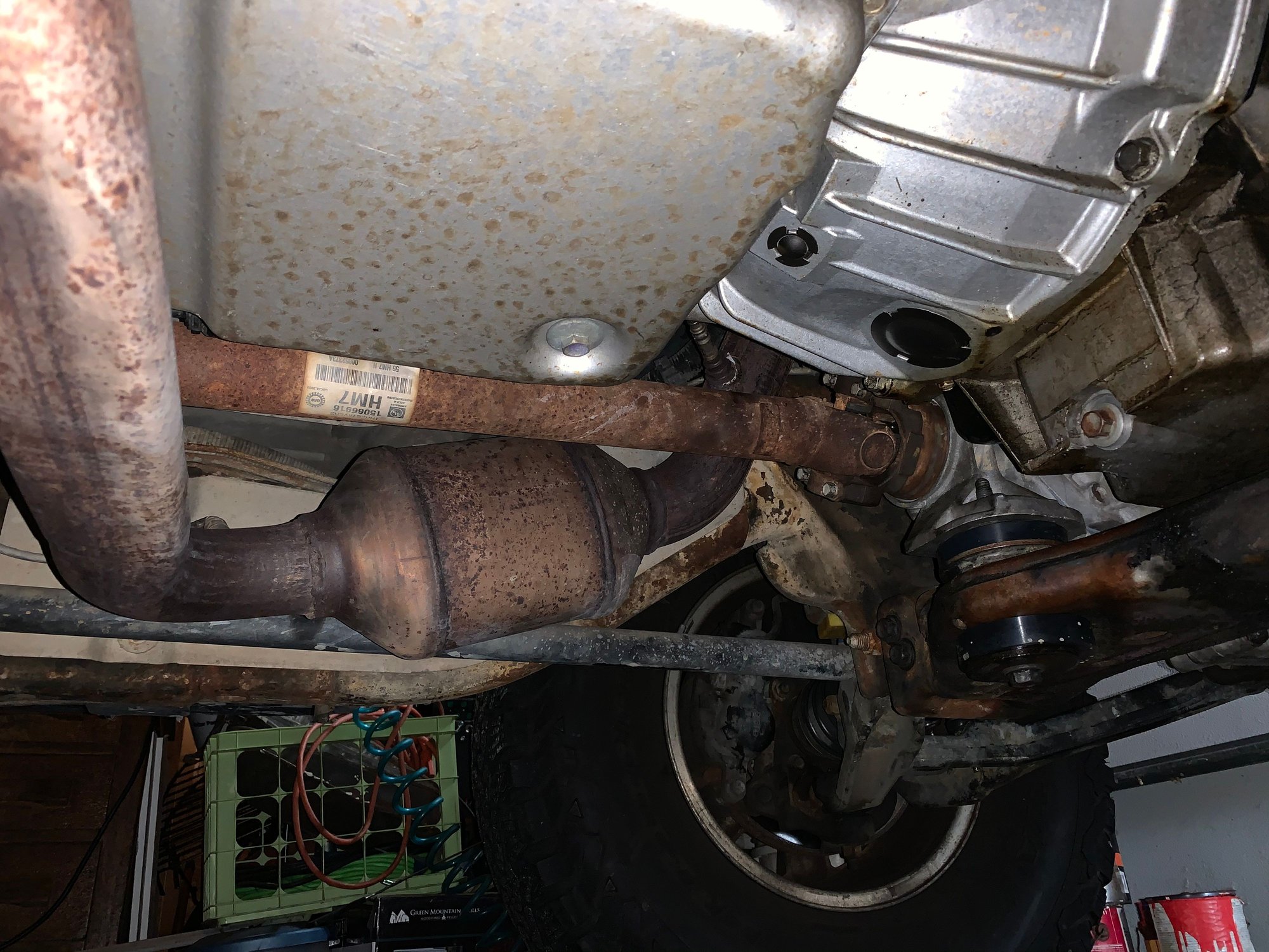

To remove the old pan is really easy since you dont even need to jack up the rig, most people can simply slide under and work comfortably on your back. Since I was going to replace the pan with a new one I decided upon the easiest way to remove the fluid from underneath- I simply grabbed my cordless drill, a 1/4" bit and a piece of PVC pipe I slid over the drill bit to only leave a 1/4" of tip exposed. This makes it so as soon as the tip cuts through it bottoms out on the PVC. I drilled by the drain plug area I believe if memory serves me right Just be aware as soon as you drill - fluid will come so have a pan under area and a tarp (etc). Once empty, there are two torx crews that hold the linkage up on side of pan, you can reach above and feel them- its a T40 I believe and you do not need to remove them , loosen just enough to lean the bracket. Remove the pan bolts. Thats it. Now you can replace the filter, gasket and install the new pan. (remember to clean the trans surface if gasket residue is present). Torque the bolts to spec progressively and by pattern. (9 ft-lb, 11 n-m), tighten the 2 linkage screws.
I had my rock guard already removed since I was doing all new fluids everywhere and was cleaning everywhere anyways...
when you fill it will NOT take full capacity of the transmission. Approx 5 - 6 quarts is a pan swap fluid capacity. What many do is over a few thousand miles, replace the fluid twice or 3x. That will eventually make all your fluid about new. Once you have the fluid at correct level, add about 5 quarts through dipstick, get truck warm shift through gears and check in park while idle- make sure you dont overfill.
Once you have at correct fluid level, you can measure what you remove and fill back the exact amount (of course recheck on dipstick) this makes future changes literally a 10 minute task.
Again verify my info on specs, refil procedure for exact methods (I am going by memory).
here is a pic of the Dorman pan installed-

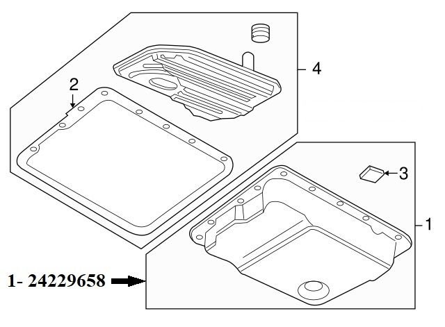

The purpose of a drain plug is to be at the lowest part of the pan. You can partially drain the pain with your plug, however you will still need to drop the pan to removed the remaining fluid/sediments.
oem pan:

I notice his pan has the indentation for the drain plug but no plug.
Old May 29, 2020 | 03:30 PM
Posts: 9,047
Correct since you would still have to drop the pan. Look at the relocated drain plug(indentation downward), now you can drain and fill, without dropping the pan, just like changing the engine oil.
