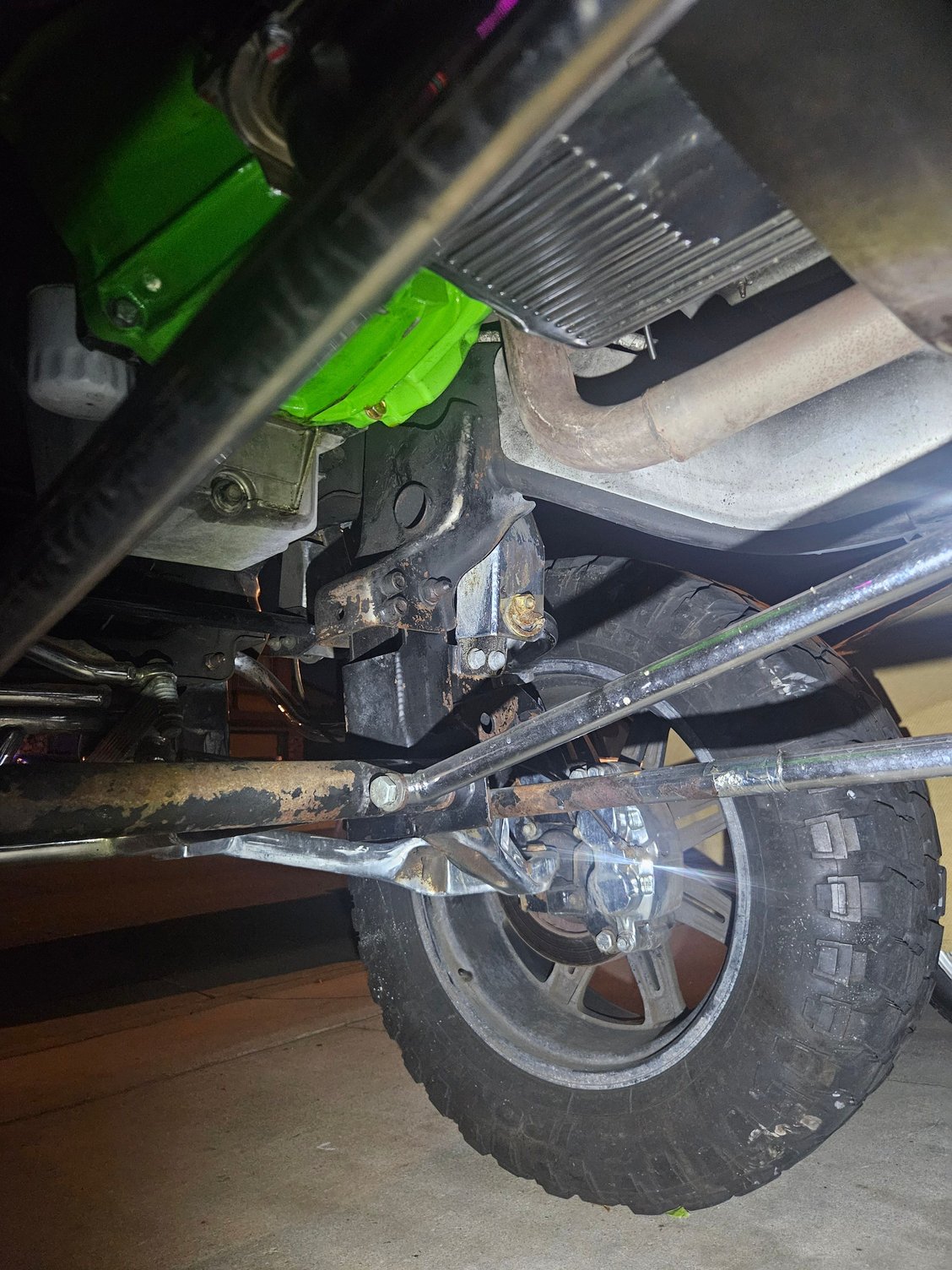

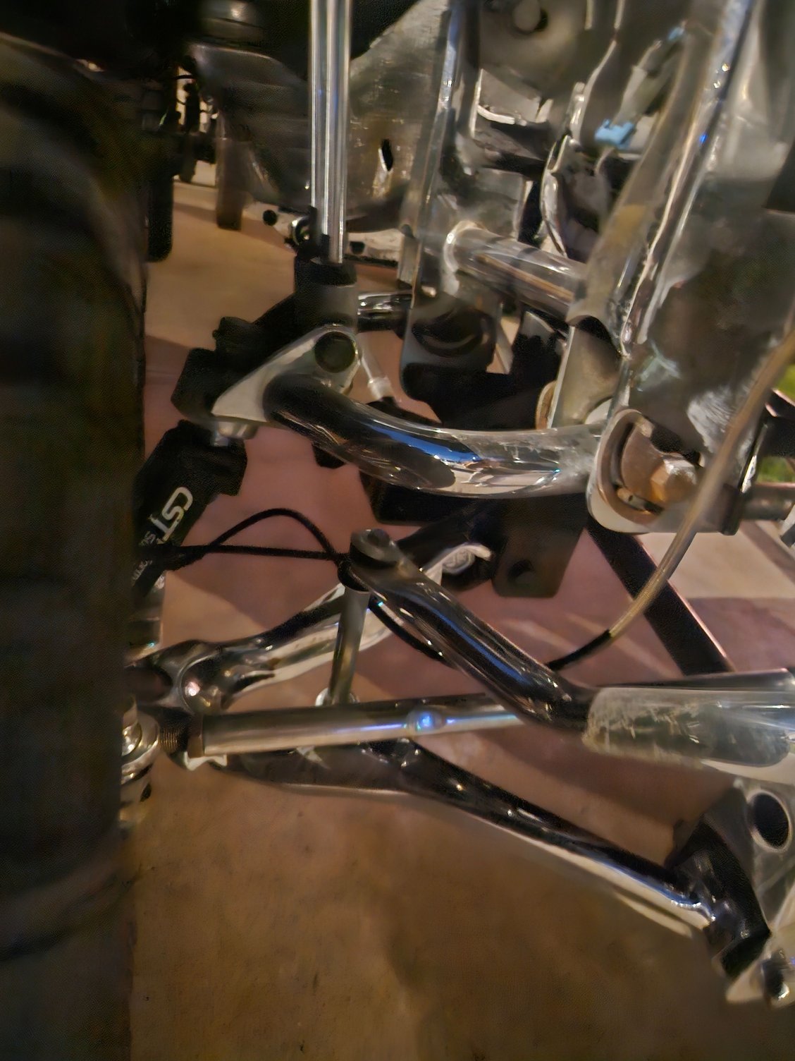

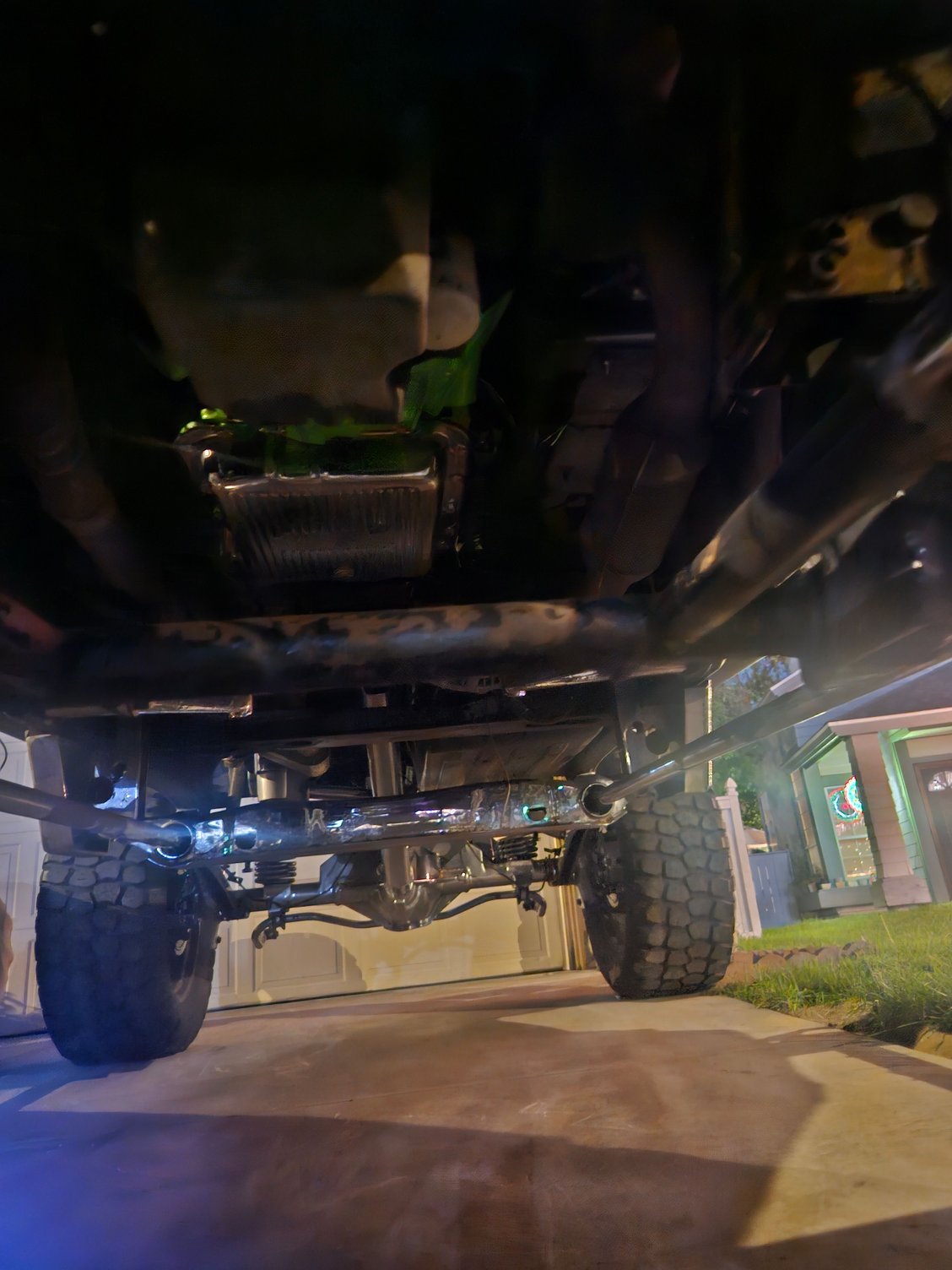

Years ago I had a shop remove the front drive shaft but I still kept the original transfer case what do you recomend i should do to make the 4L80 upgrade here's some pictures of the setup I have
Passenger side view from the front

That's an easy answer, NP-263HD, its a heavy duty 3/4 ton transfer case with a 32 spline input that a 4L80 will directly bolt to it. It is also an electronically controlled unit so it will be easier to interface with your existing transfer case control.
Another consideration, Keep in mind the 4L80 is a number of inches longer so you will be relocating the mounting. You can forget re-using your original front driveshaft it will be to short anyway.
