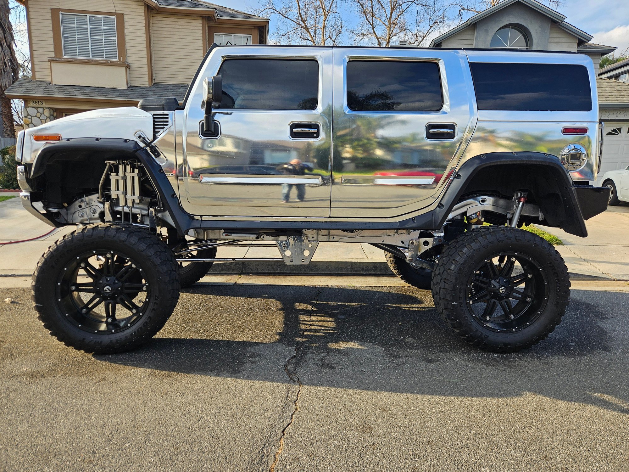

[QUOTE=hummerz;414817]What size tires are you running on? Got any pics of your 2?
12 inch lift 38" tires on 26" rims
Old May 3, 2025 | 11:31 AM
Brunob00's Avatar
Joined: Jun 2021
Posts: 266
From: Pittsburgh
Holy moly that is a lifted Hummer!

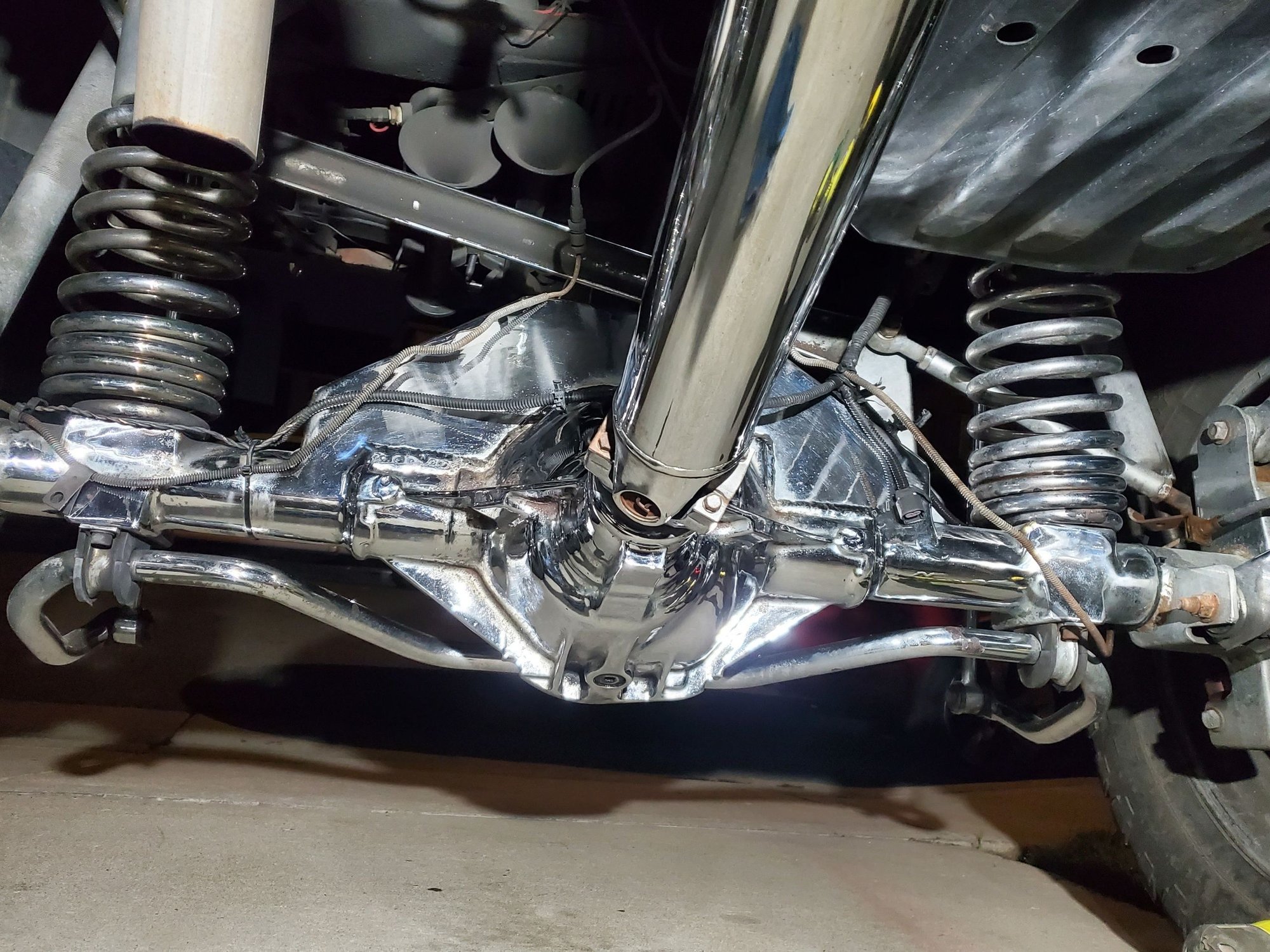

Originally Posted by Mark R
Bet you have a Nice pressure washer. When you off road that rig you'll need one... it's easy to get to the dirty side...Nice Lift.
Oh for sure, specially with all the chrome underneath, having a pressure washer is a must.
