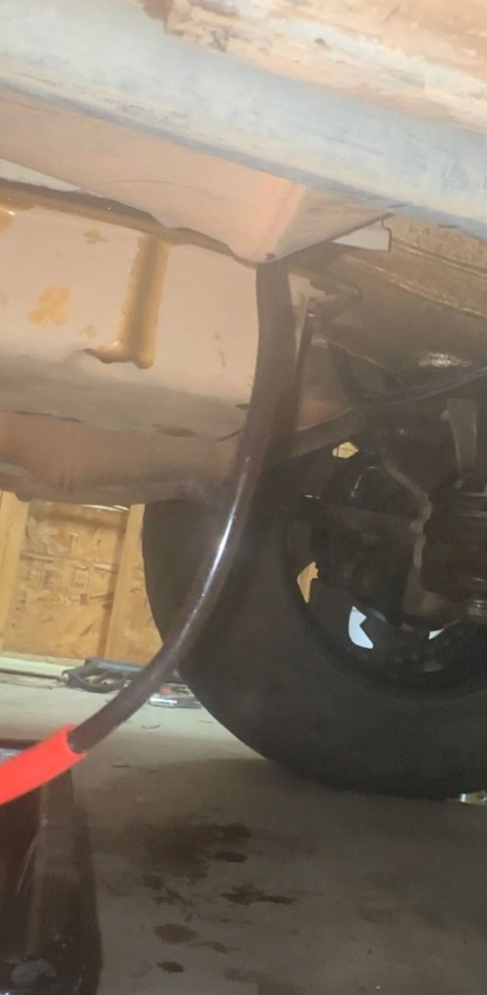

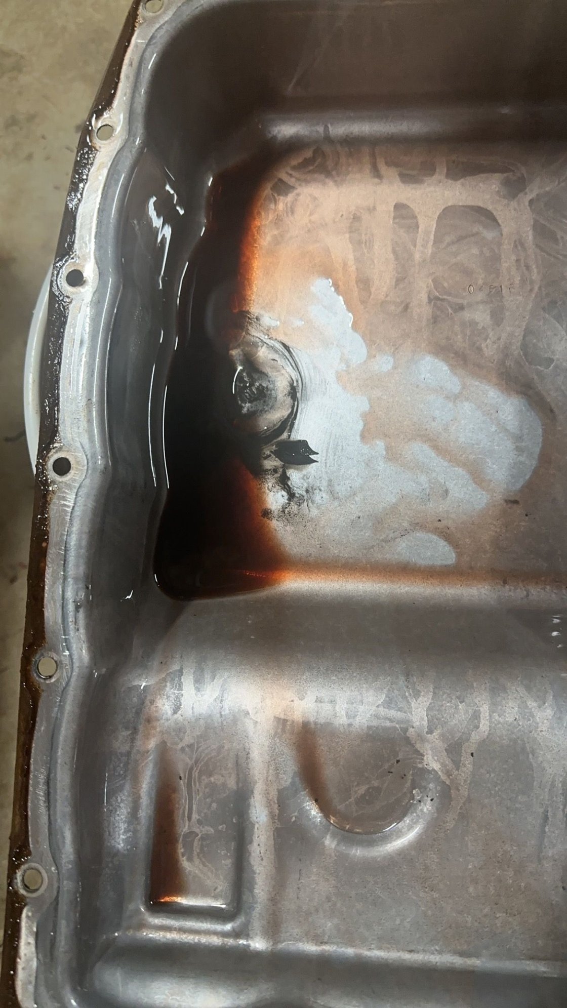

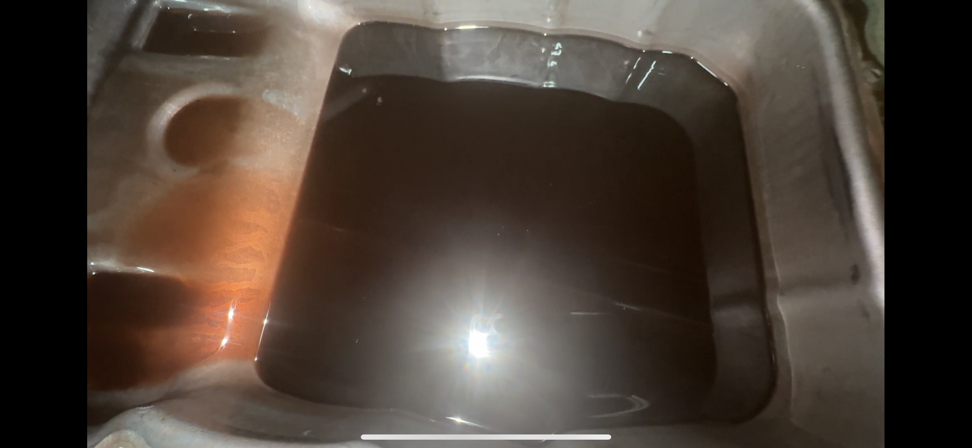

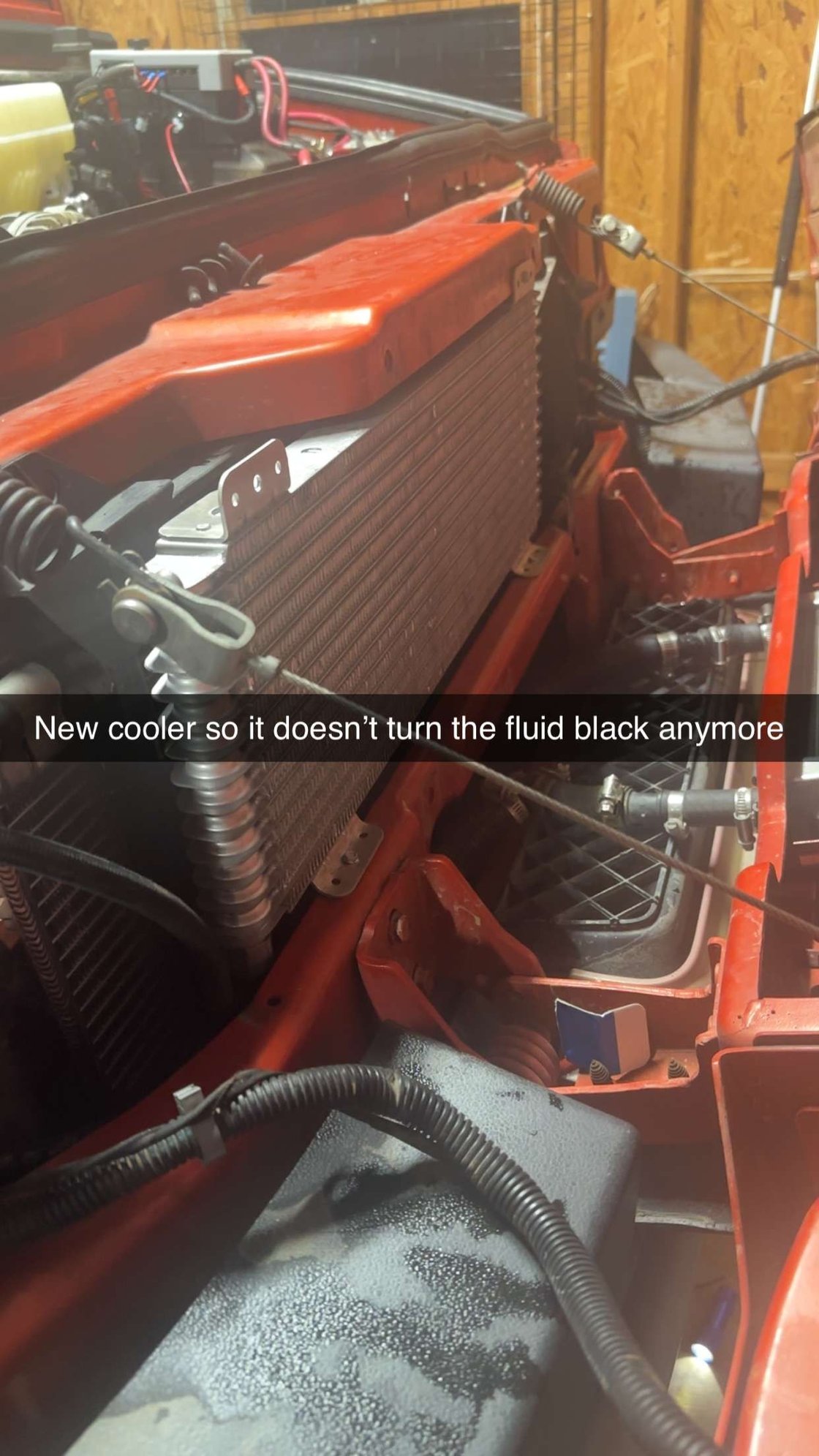

I finally got around to putting in the truecool transmission cooler on the h2. I also did a fluid/filter change and swapped out the lines for braided ptfe ones to go with the shinny new cooler. I haven’t made a bracket for the fourth hole yet. It doesn’t really need one other than it looks goofy. I picked up a 140 degree thermostat from improved racing too since I’m bypassing the radiator.
the trucks got 130,500 miles on it and the transmission has just over 40k. This is the first time fluids been changed and it was BLACK! There wasn’t metal in the pan or anything but that fluid was burnt to hell. I will never understand why gm let these transmissions run so hot. I’d see 220 in atlanta traffic and 230s when towing only half its capacity. Hopefully this will improve it a bunch. Here’s a few pictures. Ignore the goofy Snapchat captions.
not to brag or anything but the pan on my 6l80 slides right out without having to pry the exhaust.

I’ll do mine again soon because of how dark it was. I did manage to get about half of it though.
I don’t know why my truck runs so hot. Brand new the transmission was the same way. I wonder if maybe the cooler was clogged. Probably. I just threw it out though. I had to brake the corner off of it to get the line out.
Doing filter seal wasn’t that bad without the tool. I used a flat head and a claw hammer(always the right tool for the job) to get the side to crunch in and pulled it out with pliers. I used an extension in the opposite side of a large socket and the hammer to seat the new one in.
I didn’t even bother with the torque specs on the pan since I was in a hurry. I just went inside to outside, then the corners with a small 1/4 ratchet till snug and it’s just fine.
if anyone’s interested here’s the parts:
- Trucool 40k-
Amazon Amazon
- -6an hose kit (20ft with fittings) -
Amazon Amazon
- 2x transmission cooler to 6an adapters(5/18x18 inverted flare) -
Amazon Amazon
- transmission thermostat (make sure to get the 140 degree and the 6an male fittings when prompted for to add extras) - https://www.improvedracing.com/oil-t...RoCresQAvD_BwE
you also need a small pocket screwdriver you can heat with a small propane/butane torch and bend inward. This is to help when fraying the hose for the fittings. There’s plenty of YouTube videos on how to make an hose.
And a grinder with a cutoff wheel
and some electrical tape to wrap before you cut.
one thing to note is passenger edge of my cooler hits the hood bracket when closing. A sane normal person should move the power steering cooler and tranny cooler to the drivers side about an inch or two. A tired pissed off teenage shade tree mechanic who’s gotta go to work tomorrow should violently take a grinder to the hood👍
…either way will get the job done.

I can vouch for the derale coolers. The shop I work at uses them and they’re awesome. If you don’t have air suspension you can mount it behind the rear hitch receiver. Also if you do an exhaust with a smaller muffler there’s lots of room on the frame there.
with the improved racing thermostat and not having the radiator in the loop my trans warms up to 145(full operating temp) in about 5 minutes of driving It won’t warm up much when idling tho. This is in 15 degree weather too. (It’s been a frosty few mornings)
