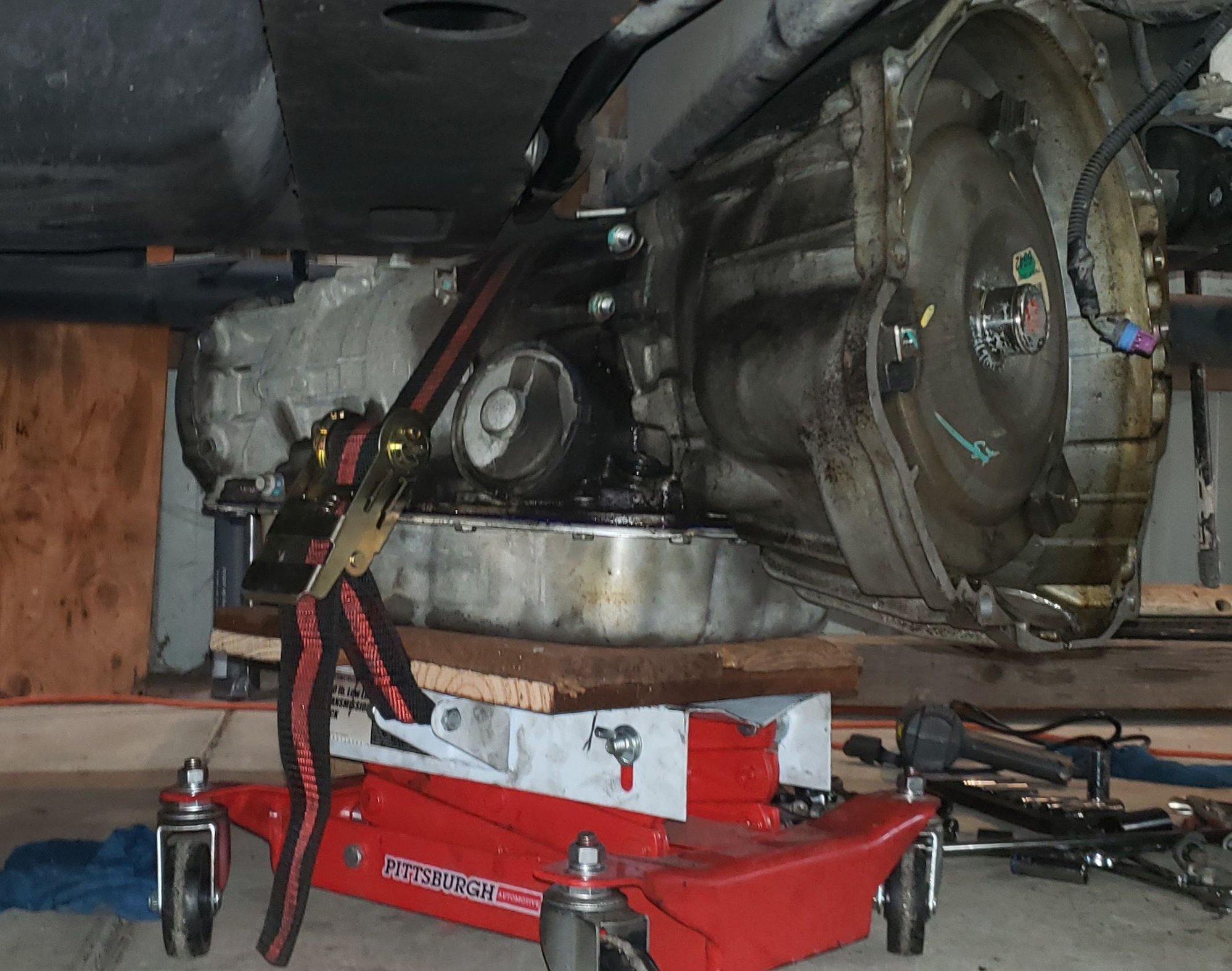

I had mine out about 6 weeks ago while doing the rear main seal on the engine. I have an inexpensive Harbor Freight transmission jack that helped out, but a regular automotive floor jack would work as well. After you disconnect everything and pull the bolts out, it's not going to drop or anything. You have to slide it back a little bit to disengage the splines. You will be sliding the tail housing back over that welding cross member that's in your way. Then you have to angle the front of the transfer case down onto a jack and then lower it. So make sure you've drained all the fluid first. And that's how I put it in. Tail shaft pointed up, raised it up with a jack and then laid the tail shaft over the crossmember. It's just a bit awkward. Not super heavy or anything. After I got it down I just dragged it out from under and lifted it up on my workbench.

Default The transmission jack I used
