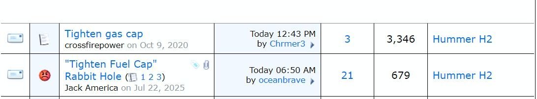

Originally Posted by Chrmer3
I may have missed it in chain- what is the exact code number you are getting? If you don’t have a cheap scan tool - Amazon has them cheap.
You missed it by 5 years! 10/4/25 threads:
