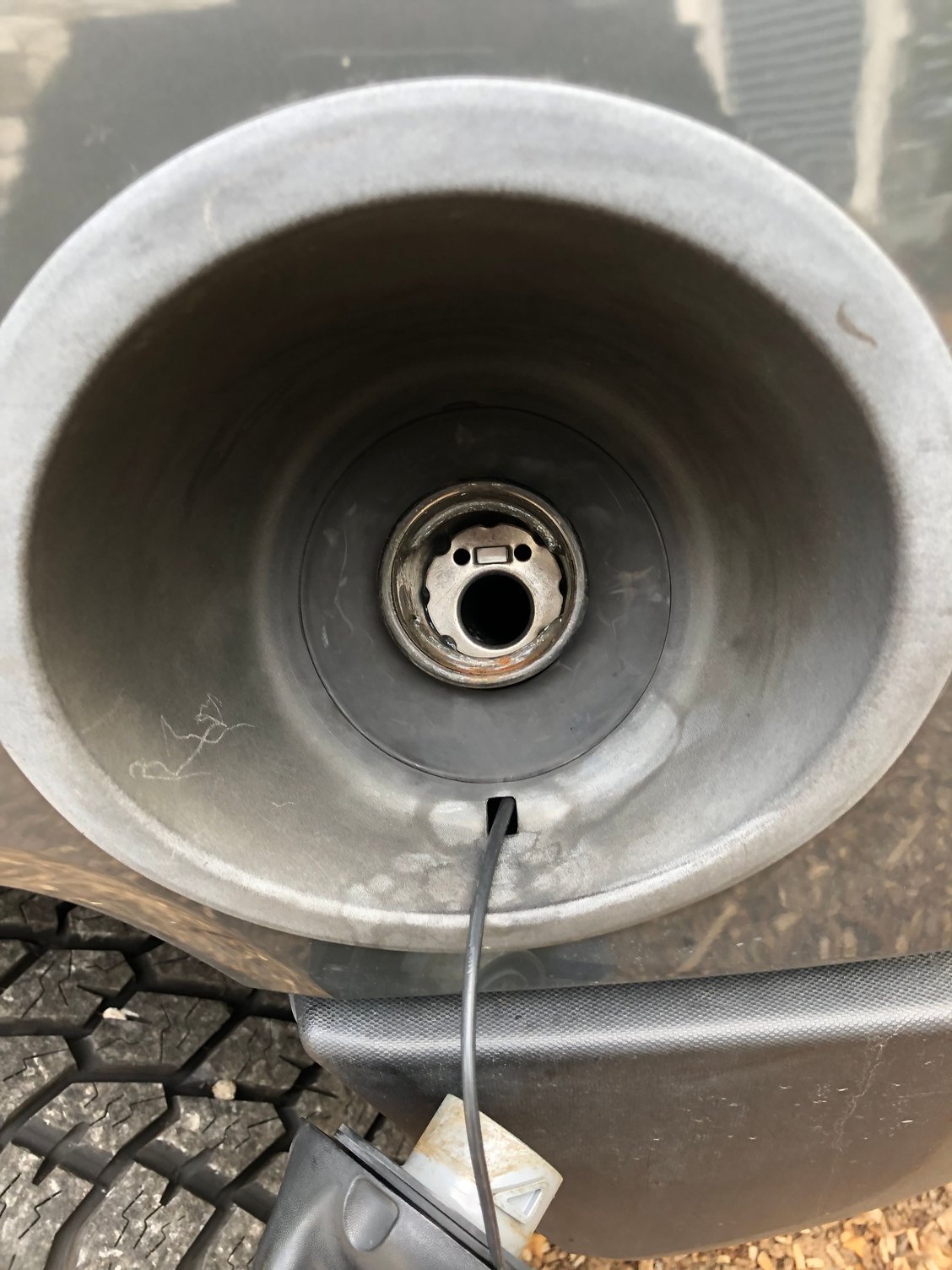

So recently I hopped in my H3 to drive home and when I turned it on the check engine light popped on, It ran completely normal and when I got home I decided I'd got to auto zone to get a error code. Anyways fast forward a couple hours and the error code is P0440, now I checked to see my gas cap was tight and it seems like it is but i ever since I got the car I never trusted the cap because to me it seemed a bit flimsy. But before I go spend $30+ on a new cap I decided I'd come here and see if you all think thats the problem and if you think I need a new cap. Keep in mind it's been a couple days since I made sure the cap was tight and the check engine light has not turned off. I'll post pics of the cap and bezel as well so you guys can see for yourselves

Wipe the dirt and crud off the Gas Cap Gasket and the filler mouth edge that the Gasket seats against.
When you put the Gas Cap on keep tightening until it clicks. Drive it for a while and see if it comes back.
Try that first even though it is highly likely that is not your problem. Gas Cap issues cause the "FUEL CAP" message to be displayed in the DIC. You probably have an EVAP leak or Purge Valve issue.

X2. By the looks of your pics, moisture is getting passed the seal(rust spots). Thoroughly clean wipe out the filler and clean the seal on the cap and silicone spray the seal too.

I had the same issue, finally found a pin hole in the fuel pump assy plate, after replacing the fuel cap. Yeppers michigan salt.
