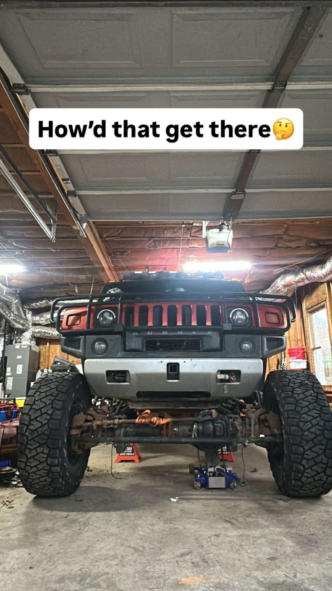

Superduty Dana 60 going in! Someone tell me if I’m allowed and I’ll post my instagram where I’m documenting it live on a story.

may be the angle of the picture, is the Dana 60 wider than the ifs?
Neal
It’s just the angle of the photo. Axle isn’t underneath not sure what oem width of the ifs was but it is only 3/4 inch wider than the rear axle hub to hub.

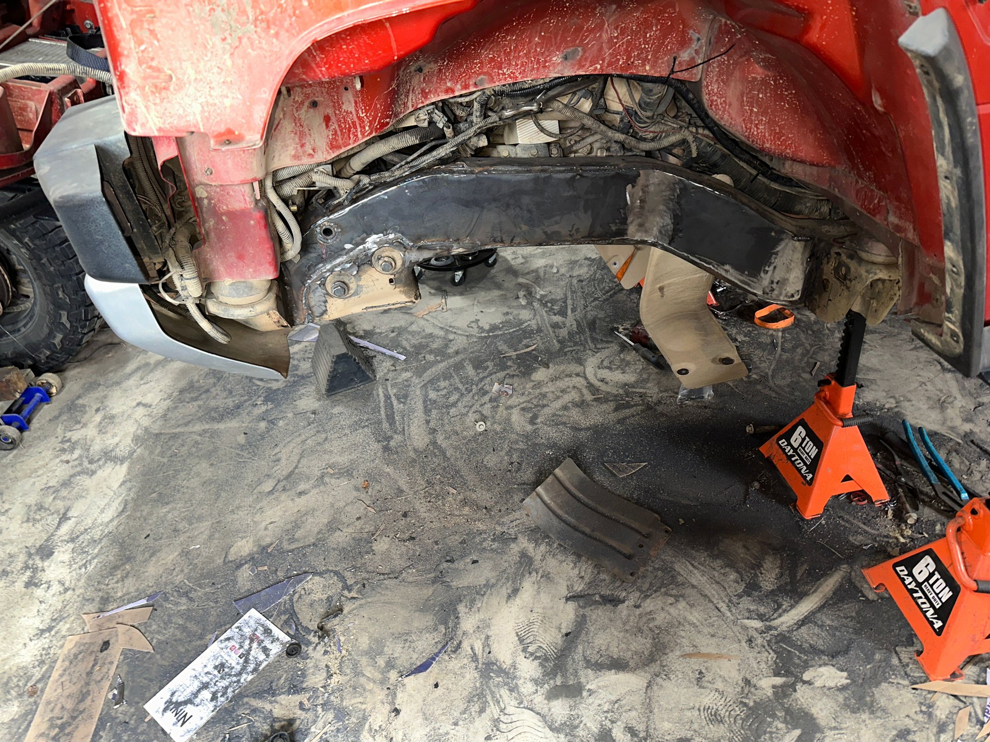

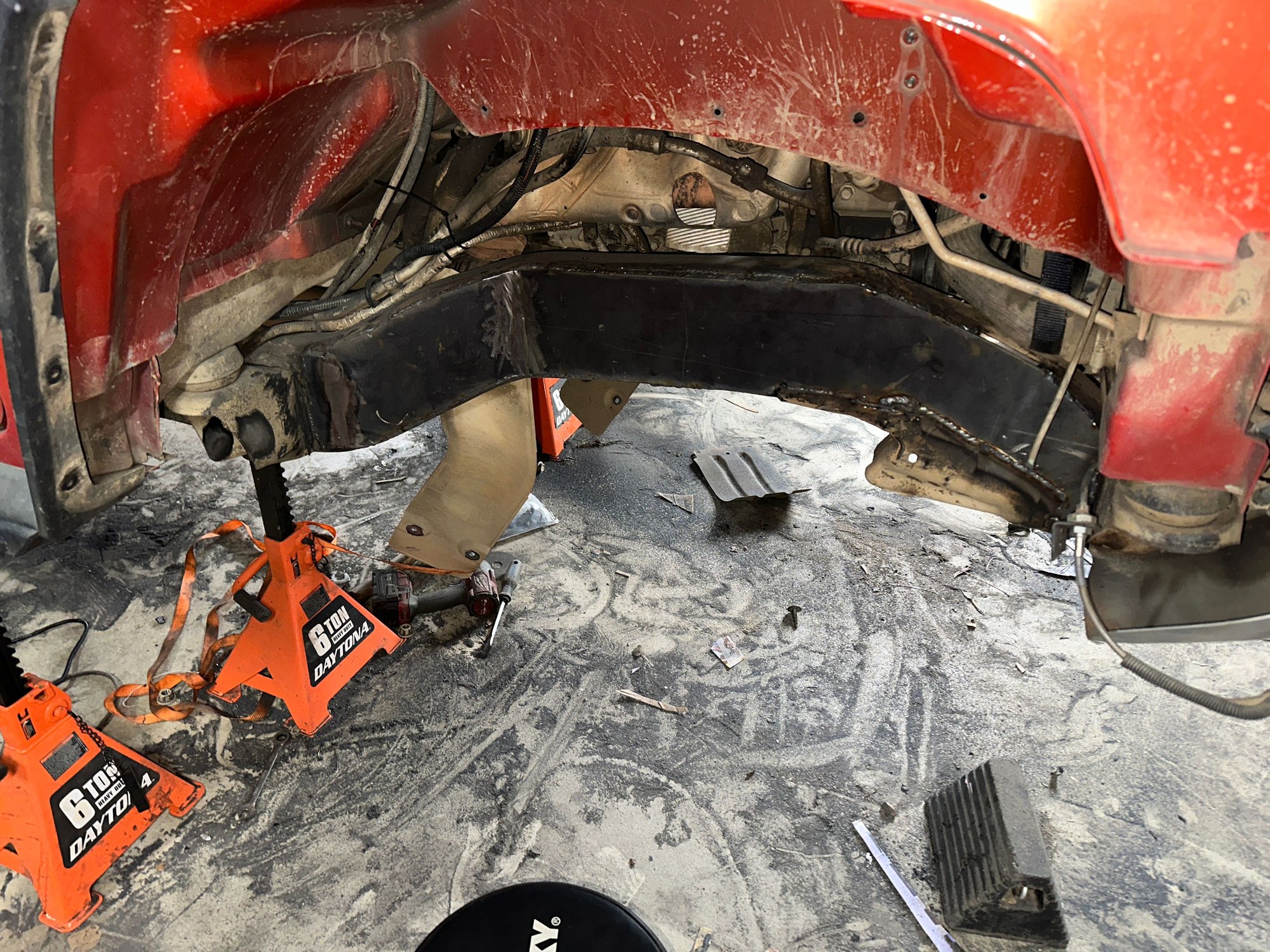

Next(the scary part) unbolting and cutting off all the ifs. No going back after this. I used a sawzall to cut the upper control arm tabs and both crossmembers where the lower control arms mount. I just cut the crossbar out of the front one but left the part where the sway bar mounts too. That way I can run one later if I need to or install the steering box brace made by WFO concepts. Once everything is cut, I used a few flap disks to clean up everything flush with the frame.
I recommend the Diablo 12 inch sawzall blades and Benchmark Abrasives(Amazon) 40 grit flap disks for quickly removing material. There seriously is nothing like these benchmark flap disks. it’s $25 for a pack of 10 and I only used 2 for the entire front section of the frame. They just keep going.
Make sure to unload the torsion bars before cutting or unbolting so you don’t die. On the note of safety I left the rear wheels on, chocked them, parking brake on and placed two jack stands right behind the first body mount behind the front wheels.

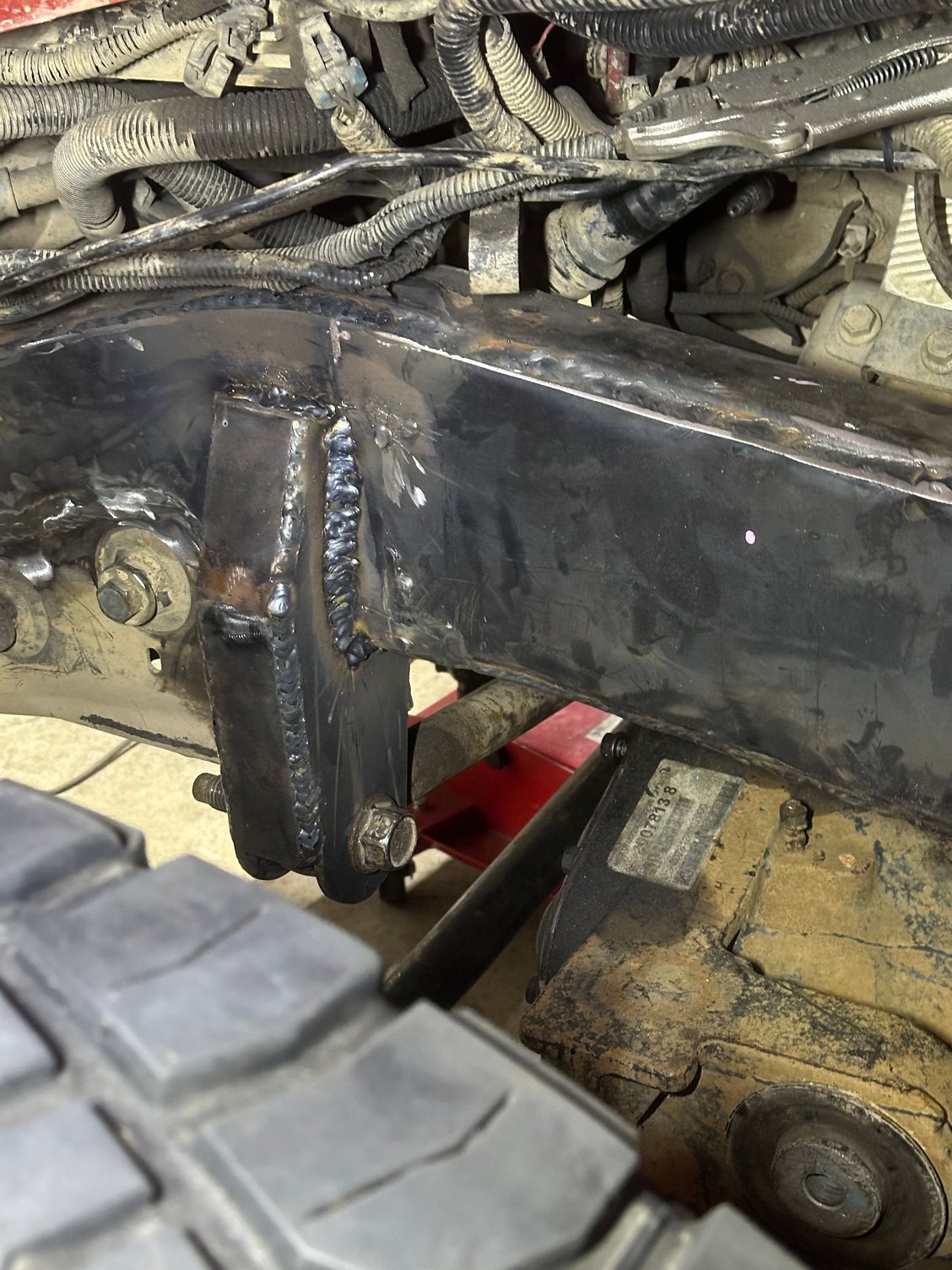

This was by far the hardest part of the entire project. I started with a cardboard template on the drivers side and tried to manually cut it out with a plasma torch. Found out that was a pain in the *** so I finished it with a cutoff wheel and a grinder. I cut vertical slits in the plates to make them easy to bend and contort to the lateral bends in the frame, welding them up afterwards to restore rigidity.
After a few days I had a piece I could call good enough. I then made better cardboard cutout of the plate to put on the cnc plasma table. I used the table to mark several points and plot them in onshape where I could make a few edits and cut it out for the other side. Much easier and way cleaner looking.
My coworkers looked at me crazy when I spent two hours figuring out how to plot points in a program but it beats the hell out of 2 days worth of grinding.

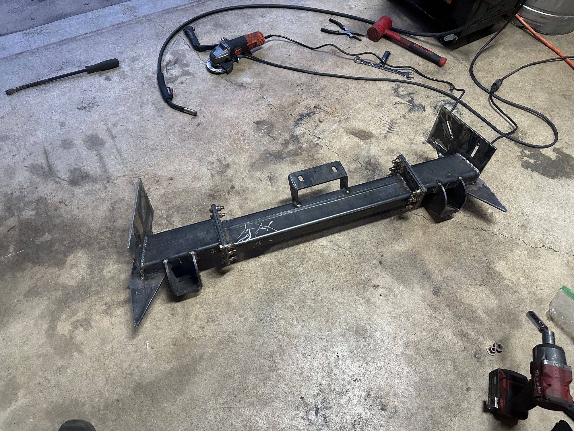

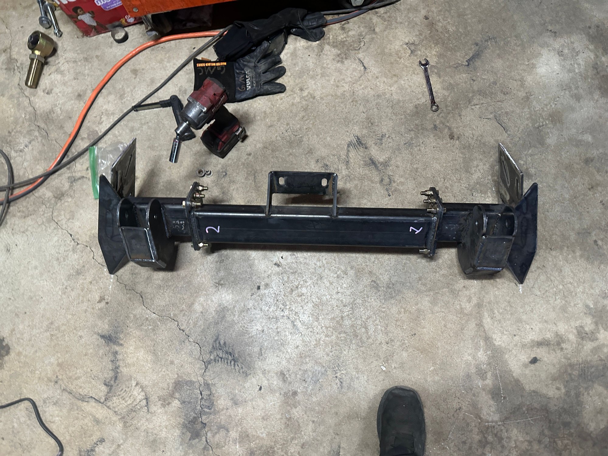

I started out by unbolting the trans mount from the crossmember and using a large ratchet strap to hold the trans just barely up off the mount in order to make measuring for the new mount as easy as possible. Then I cut the entire crossmember out including the large tabs that are welded to the frame and ground it all flat.
To build the new crossmember I started with plates that cover the entire angled section where the tabs were. Tacked them in place and measured and cut some 2x4x.25 inch rectangular tube at the same angle so it fits snug between the plates. It’s important that the tube sits 1/8 inch from the edge of the rear of the plates and flush with the bottom. That way it can be welded sufficiently to the plate and there’s room for a trans mount bracket in front.
I then cut the tube 8 inches inward from the outsides and took 1/2 inch out on each side for the connectors for the removable center section. This is simply made of 1/4 plate with some bolts through it. The center section is offset 1 inch below the bottom of the frame while the outer sections are flush with the bottom of the frame. The reasons being I needed an additional inch to clear my np263s encoder motor that hangs down below. You may or may not have to do this with the stock 4484 case. I also wanted it to protect the transfer case from rocks since it hangs down about an inch below the frame from factory.

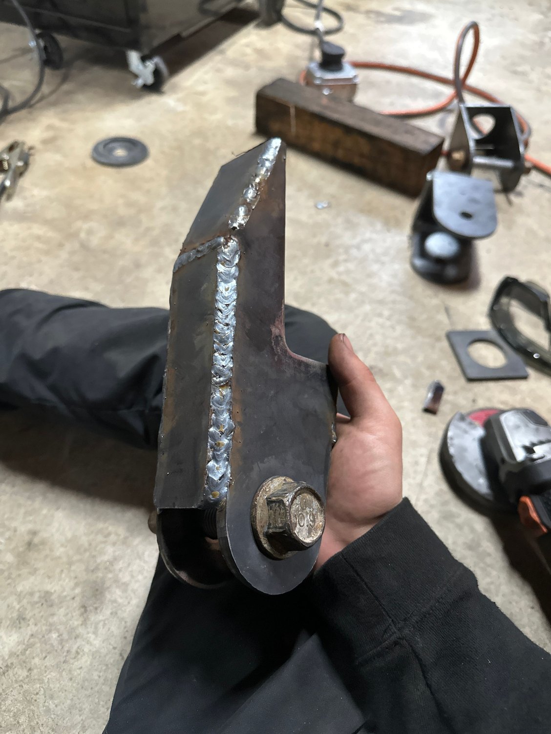

Lastly, I welded on the radius arm mounts and lower support gussets. The radius arm mounts are meant to hold a duraflex 7315 bushing. The lower gussets are super important because the tube is welded toward the back side of the frame plate and has little to stop it from being pushed backwards. Not pictured I also added two vertical top gussets on either side. Probably overkill but I figured it would help against landing on a rock or something.
Trans mount is pretty self explanatory, same location as factory. I don’t have a bender so every bent piece was cut on the cnc with slits at the bend line, bent in a vice and welded over on both sides.
I actually made a bad mistake when building this crossmember but it ended up being a blessing as you’ll see later. The axle side bushings are 35” apart and due to not measuring twice… I fully double side welded my radius arm mounts on at 34.5” apart. However I would do it exactly the same if I did it again.
