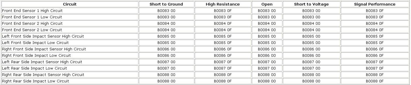

@HellHoof
Is yours an 08/09?
B0083 carries a descriptors i.e. additional "byte" of information as follows:-
  • DTC B0083 00: Electronic Front End Sensor 1 No Additional Information (Left)
  • DTC B0083 0F: Electronic Front End Sensor 1 Erratic (Left)
  • DTC B0083 39: Electronic Front End Sensor 1 Internal Electronic Failure (Left)
  • DTC B0083 3A: Electronic Front End Sensor 1 Incorrect Component Installed (Left)
How this extra byte is obtained form the scan tool unclear, however further info is below:-
Conditions for Running the DTC
Ignition voltage is between 9-16 volts.
Conditions for Setting the DTC
Any of the following conditions exist for 2.5 seconds:
B0083 00, B0084 00, B0085 00, B0086 00, B0087 00, B0088 00
• The front end sensor has been shorted to voltage, open, or shorted to ground.
• The front end sensor current has been above 23 mA for longer than 5 milliseconds.
• The SDM has not received a message from the front end sensor for more than 375 milliseconds.
B0083 0F, B0084 0F, B0085 0F, B0086 0F, B0087 0F, B0088 0F
The SDM has received erratic messages from the front end sensor.
B0083 39, B0084 39, B0085 39, B0086 39, B0087 39, B0088 39
• The SDM has received a Not Ok (NOK) message from the front end sensor.
• The SDM has not received a message.
• The SDM has received invalid serial data from the front end sensor.
B0083 3A, B0084 3A, B0085 3A, B0086 3A, B0087 3A, B0088 3A
• The SDM has received an ID message from the front end sensor, which does not match the ID stored in the SDM memory.
• The SDM has reset the front end sensor twice without detecting the correct ID message.
Hope the above info helps, this YT Video may also be of help even though its for an 05

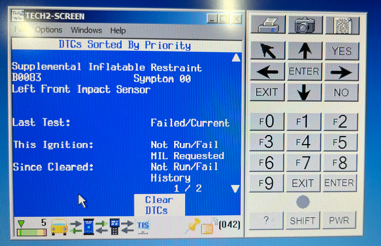

Yes, 2008. That table is great! My extra code is 00, and that does show in your table. I'm assuming it's the Symptom showing on the right side. (ignore that it says there's another code - that was because I was messing around in the programming screen and restarting it cleared that second code).
