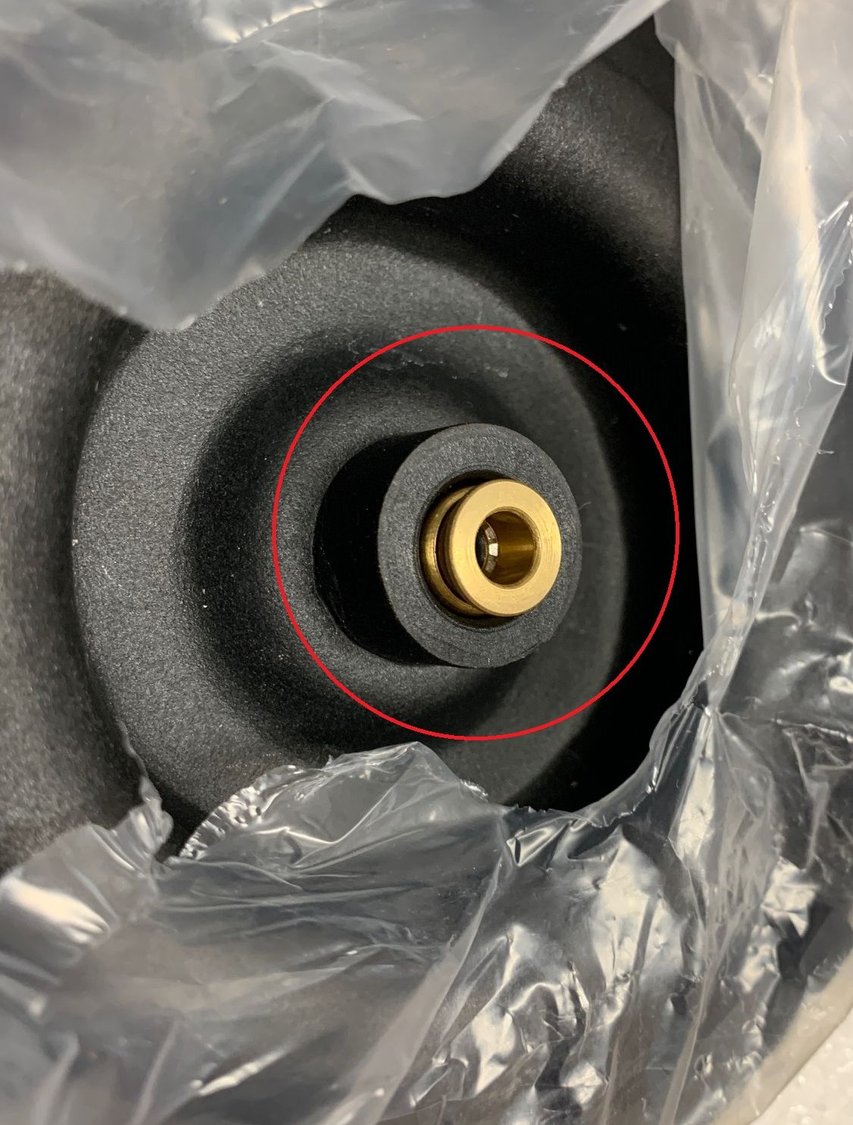

I wish it would be that easy, Here's a pic of some brand new airbags, You can see the fittings are knurled and pressed in. No way to remove them to replace them with 1/4 inch without destroying the bags.
And trying to go the other way, At one point I found an adapter from 1/4 to 6mm but the company had sold out then went bankrupt. Trying to find schrader valves in 6mm and also the connection points to switch out on the Firestone compressor is also difficult as they are not offered by Firestone either.

HummerZ, do you think the original fitting is actually screwed in? I would hate to ruin a brand new set of bags trying to remove the original air fittings? Thx

if they look like your circled picture they are most likely molded in not screw on.
i guess you are looking for something like this instead?
I doubt it. Contact the company I posted above for same fitting with NPT male to attach to compressor or get a
1/4" NPT Male to 1/4" BSPP Female Adapter 1/4" NPT Male to 1/4" BSPP Female Adapter
then pipe it in with
6mm OD Push to Connect 6mm OD Push to Connect
EDIT>>>the 6mm kit above has 1/4" npt male to 6mm push connect fittings included.
