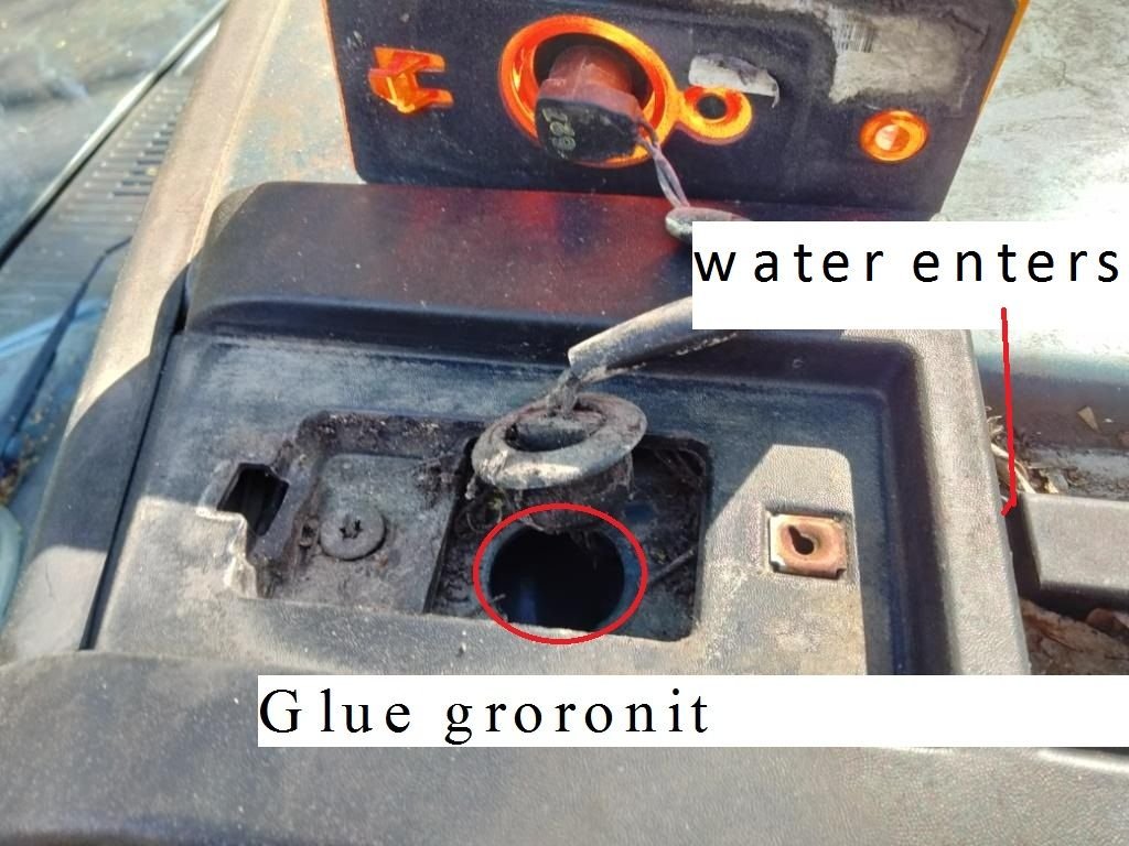

Sealing the front roof light leak (unsure if rears leak?)sean a few videos of ppl replacing gaskets, I don’t see any gaskets just a large sponge pad under the whole lens.
I’m thinking the rain water enters interia though the round grommet? Like the water enters though the roof rack rail then though the round grommet.
Planning to glue the round grommet, thanks for any tips.
do the small lights also leak or just the large outside lights?

The foam gasket on the amber lens needs to be replaced.
correct. That sponge pad is the gasket. You will probably have to buy a set so do them all. I found my clips get bent taking them on and off so make sure you adjust them so you get a good tight fit. Probably controversial, but I also added a thin film of silicone. Not globbed on but just a thin film.
you can buy a whole set with new LED lights on amazon for about what the gaskets will cost.

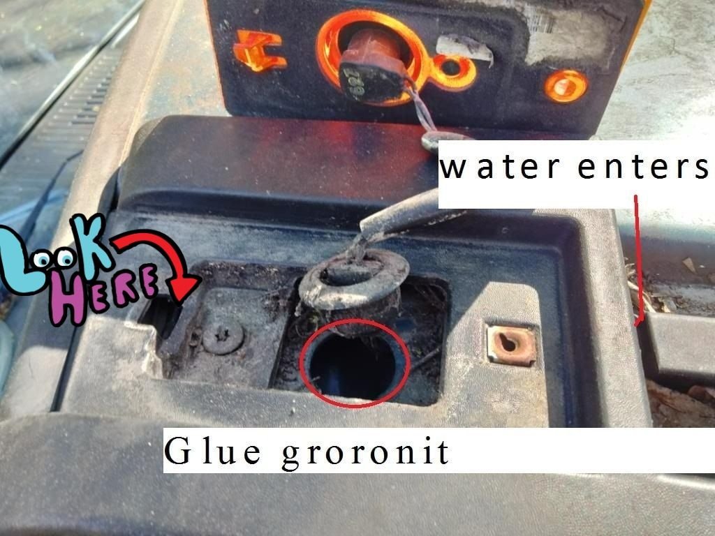

Seal the lens mount> there's another opening underneath:

I did this about 5 years ago with 100% silicone. The corners are leaking again now. Someone needs to find a better solution for this.
