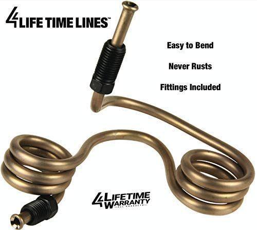

Just follow the line, make sure you can see where it connects to the fitting. Cut the line from the fitting, remove the fitting with a socket wrench, remove the line from the fitting, clean the fitting. Get yourself a flaring tool and copper tubing. Feed the tubing through tight areas(make sure to protect the opening on the tubing so no debris gets inside, while you are routing the tubing). Route the tubing as oem, install your fittings on the tubing, then make a proper flare to seal.
Do it with copper and you will never have to worry about it rusting out. Properly bleed the system, then check for leaks.
This set includes new fittings, check to make sure they work on your application, or reuse the original fittings:
Amazon Amazon
