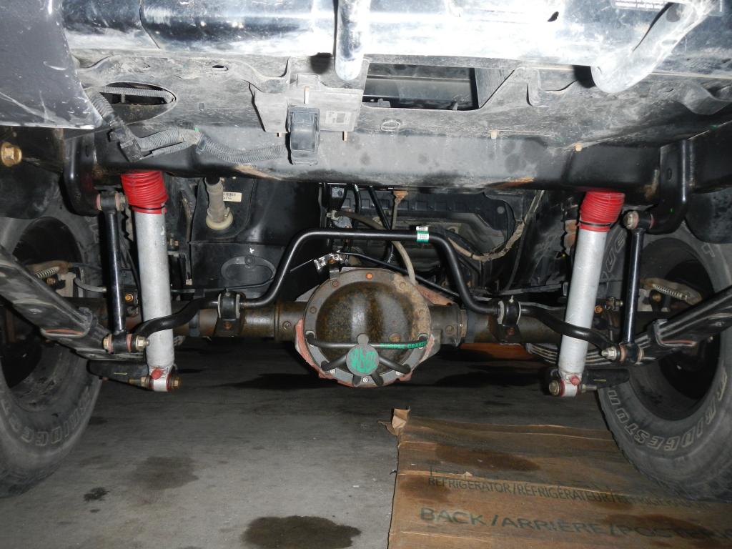

Sorry about that, they don't have our vehicle on the site but when you call them they will make in on the spot. They'll ask what you got and what size you want and the outside color. When I put on my lift I had the rear line made 6+ on the OEM length in black for $85.
