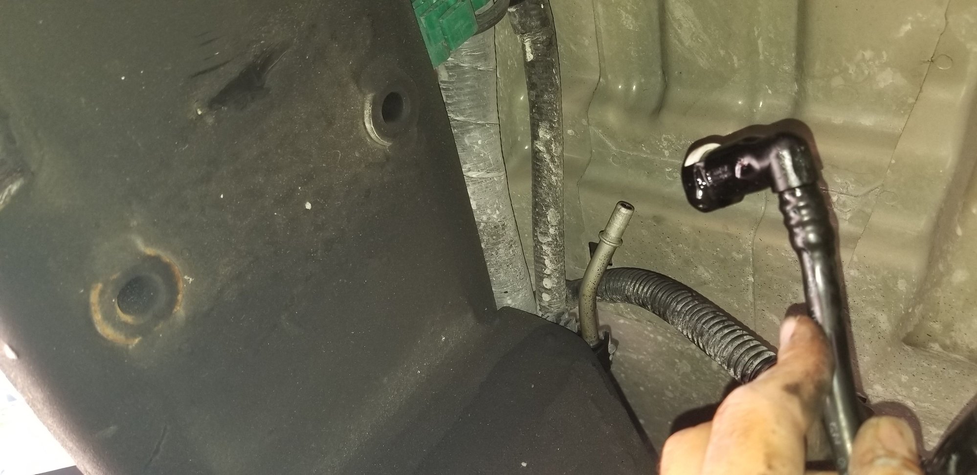

LOOKING AT THE LOCATION OF THE
Diferent location of the fuel tank vapor vent pressure sensor
Originally Posted by H2Miami
Neither the blue or the red circles are the pressure sensor. From 2005 to 2009 the pressure sensor is built in to the fuel pump. What you've circled are tank venting ports for the EVAP lines.
