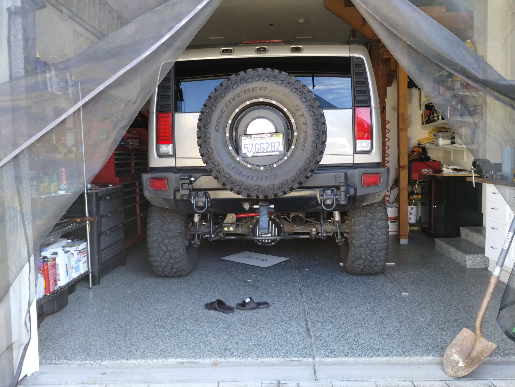

Both rear tires are not sitting correctly. Looks like right side has positive camber and left side has a bit of positive camber as well. It is sitting 1/2" higher on drivers side. Tires are wearing normal. Has a slight vibration on highway at 85mph. Never been in an accident.
I have an adj. panhard , trackbar , which was set when shop did alignment. It has a 6" Fabtech lift and tires are 37's ( 13.5 x 18 ).
Any ideas ?

try adjusting the opposite front torsion key

How many times has it been jumped off a berm or sand dune?

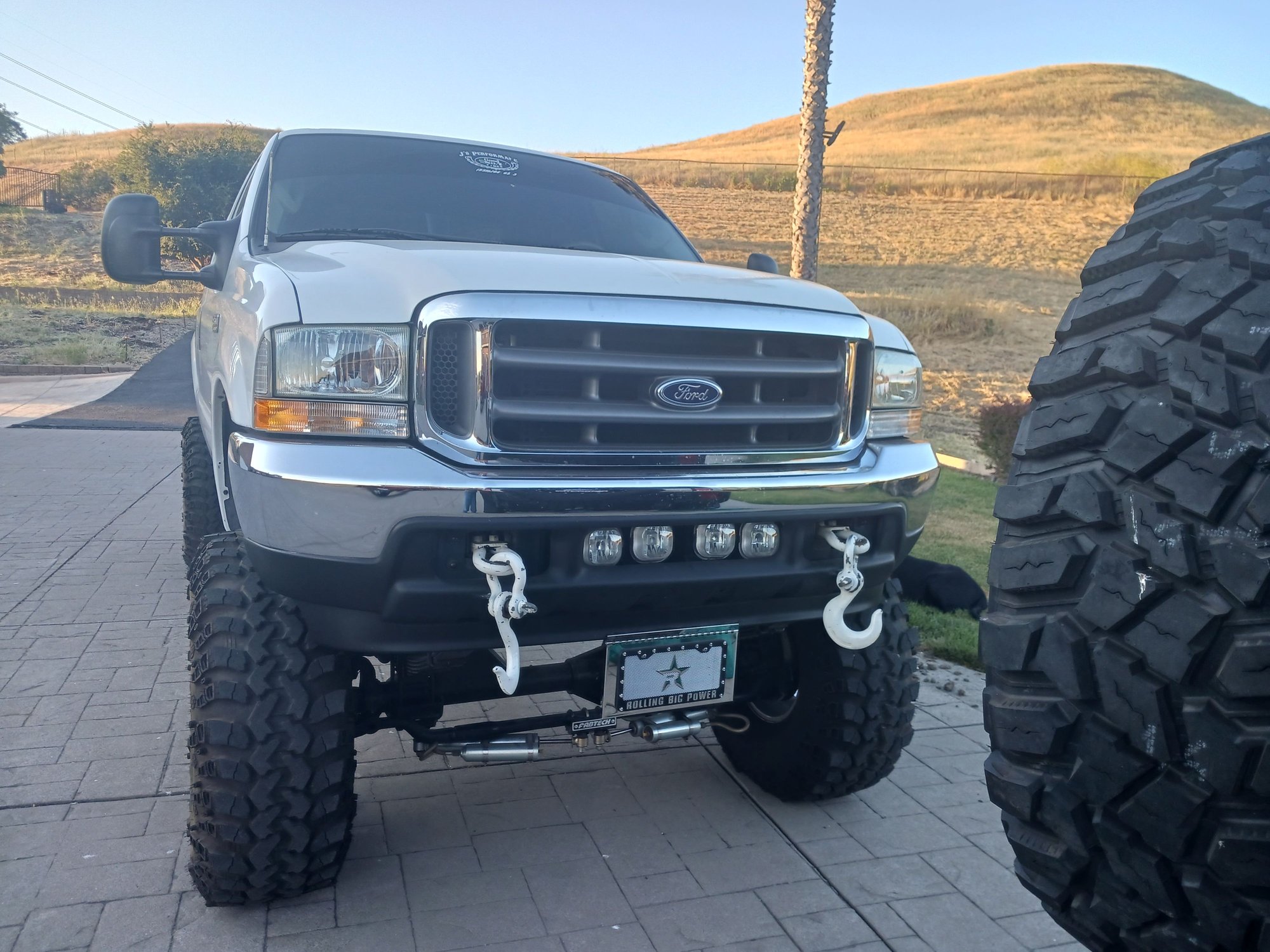

I have never taken it off road ( yet ) and I am the original owner. Even though its my daily driver , because I work at my home , I hardly ever drive it. It only has 56k miles. My other truck , pictured , is the one I take off road .
