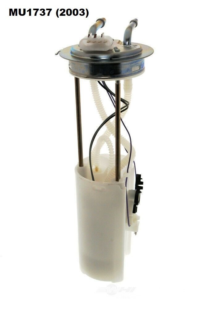

FPM comparison:

Originally Posted by joachimelle
Hi all. I know that on some this are on the fuel rail, but it is not there. I have followed the fuel lines all the way back to evac tank and then to the fuel tank. But no sign of filter or pressure regulator, is it all on top of tank? :-) Thanks for answers.
Just to be clear, you only have 1 fuel line(supply) +evap line(burn vapors) Returnless fuel systems since 2004. Returnless EFI systems typically operate at a higher pressure than return-type systems. This is necessary to reduce the risk of fuel boiling and vapor lock in the injector supply rail during hot weather (since there is no recirculation of fuel from the engine back to the tank to keep the fuel supply rail cool). The FPR is mounted on the pump found in the FPM.
