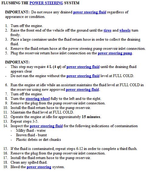

can't believe I can't find that article...it was like 6 pages long. Here are the directions from the service manual. I would spend the extra and go w/ Royal Purple Synthetic PS Fluid. There is a noticable difference just running synthetic fluid through the system. Your brakes and steering will apprechiate it.
