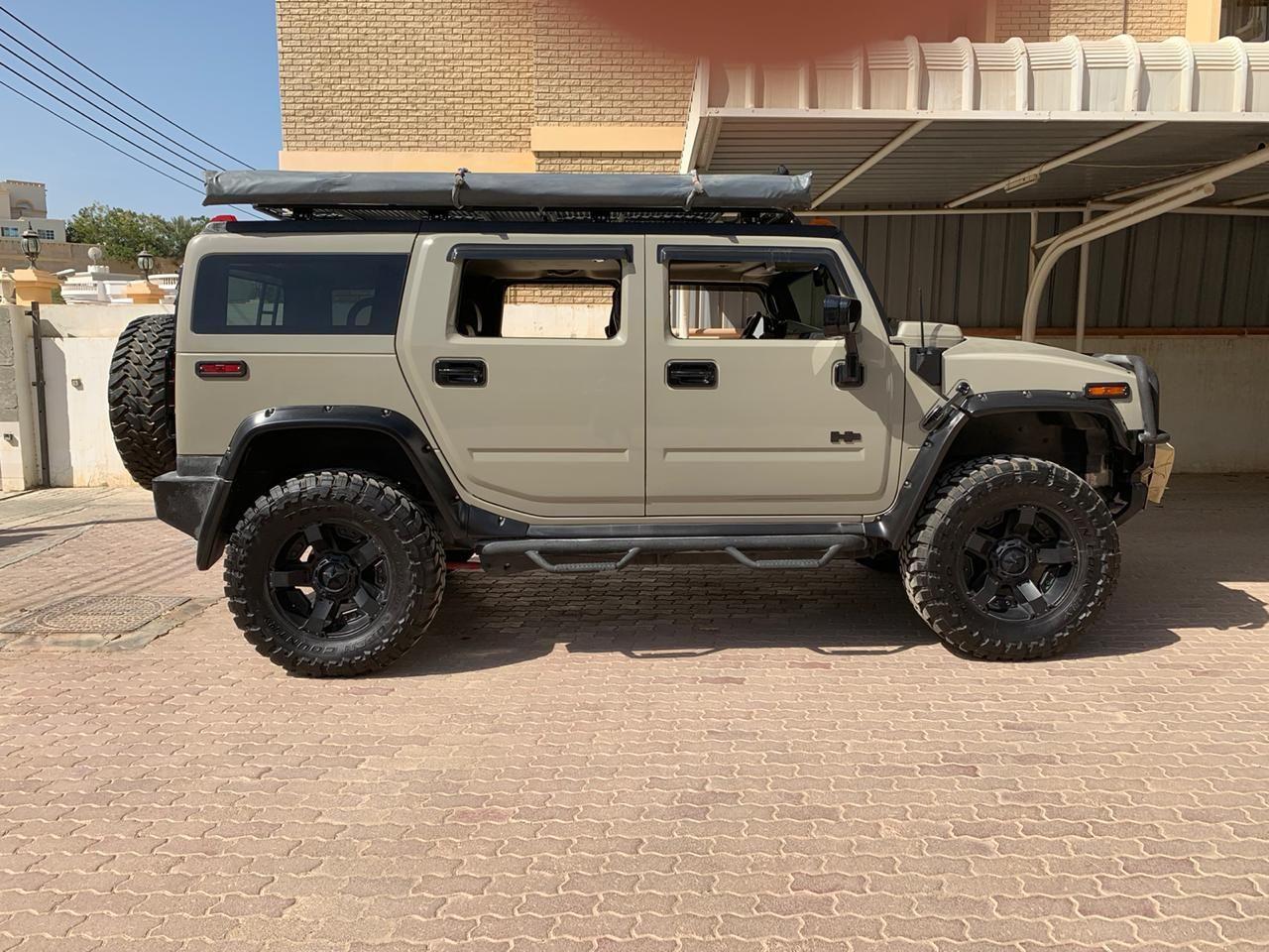

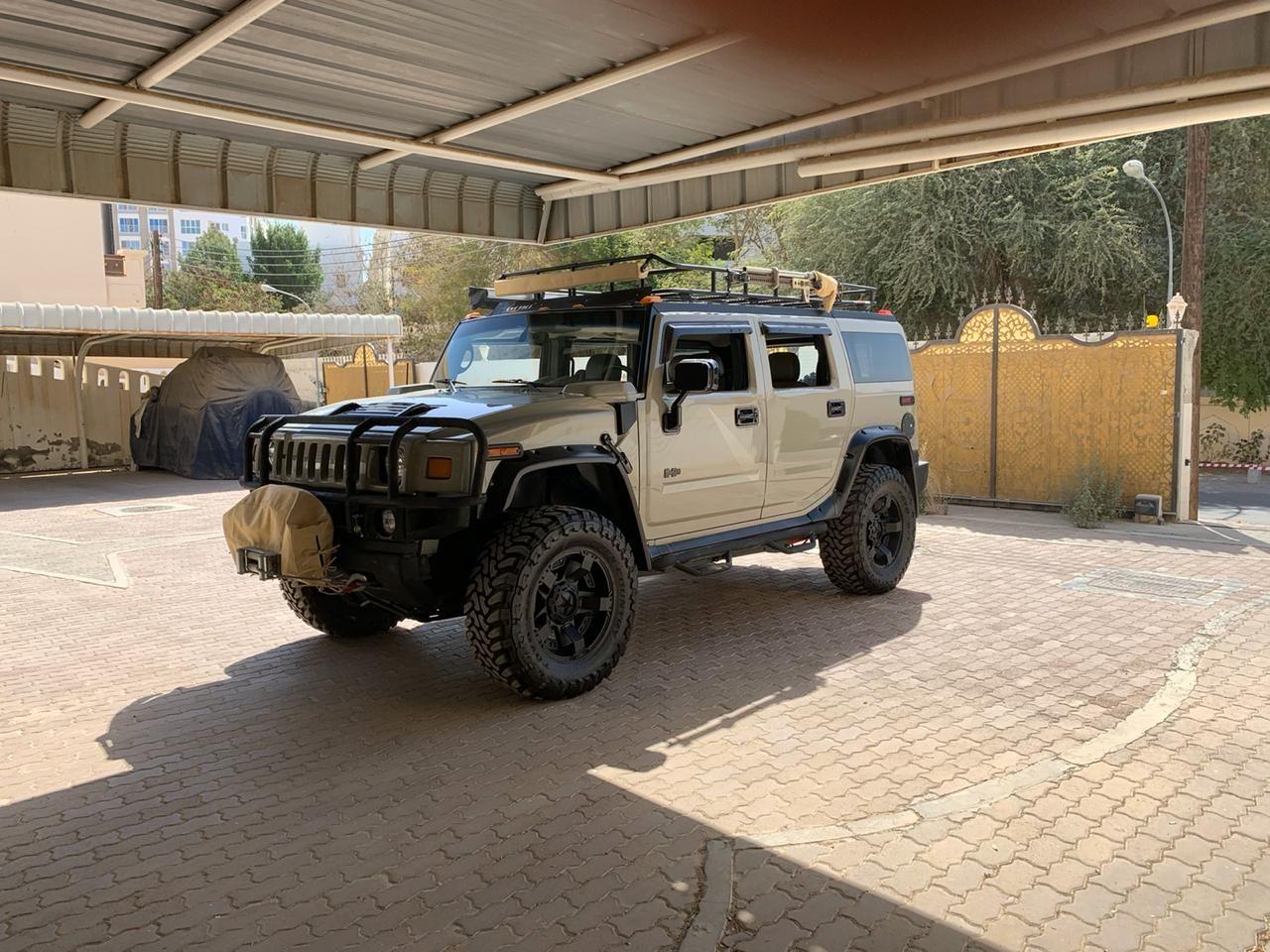

i have it on my H2 paired with Granatelli Motorsports 350120-C tuned Mass Airflow Sensor and i can truly feel the power of the 6.0. Having said this, i also have the "Air Doc" and "Custom DiabLew Tune" with "long headers" and full "MagnaFlow" exhaust system,
So i'm certain that the performance gains i have is a blend of all the above.

very nice rig you have there. Looks fantastic, usually I don’t care for replacement wheels but yours fit the look perfectly!
