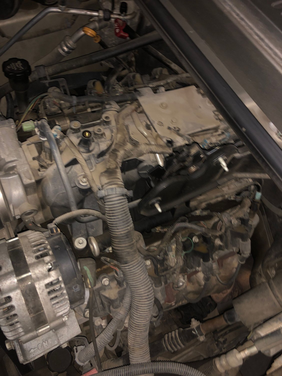

Can’t find the oil pressure switch?

Yes the problem was from the oil pressure switch, After i have changed it the problem was solved. the pressure is reading now around then 35 psi when it is running. And 0 when just the key is plugged.
