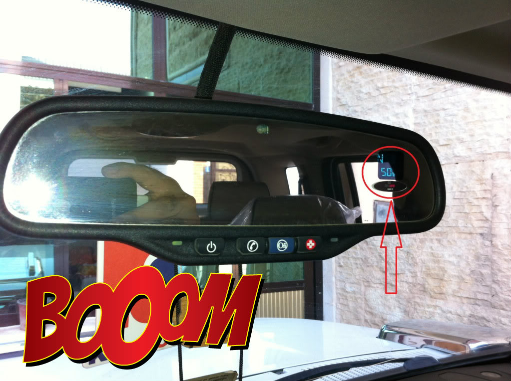

thanks bro and sorry for typing mistakes my car is straight L5 with 3.7l engine i just corrected the post any way do you recommend me to use 5w30 even in Hell weather which riches 50 and 53 Celsius i just want to ask you is it wrong to use 20w50 acdelco or 10w30 acdelco oil in summer hell time thanks in advance

yes bro thats the 400 millilitres is equivalent to 0.42 US quarts i added that much oil to see the oil level back to middle of L and H
