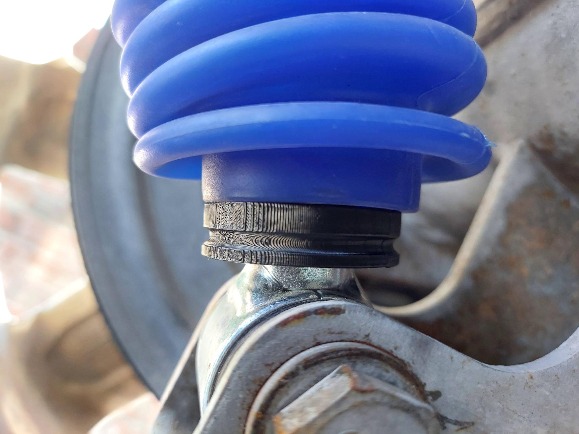

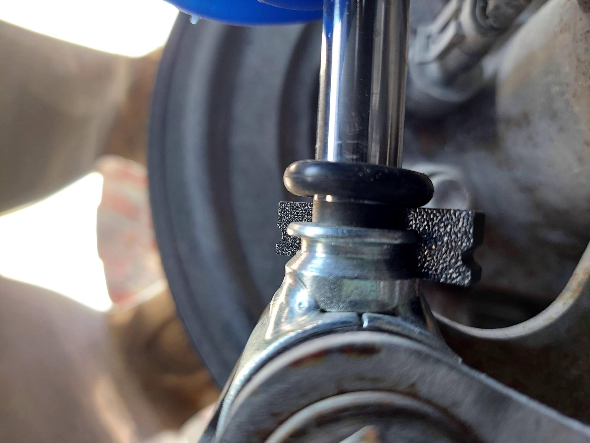

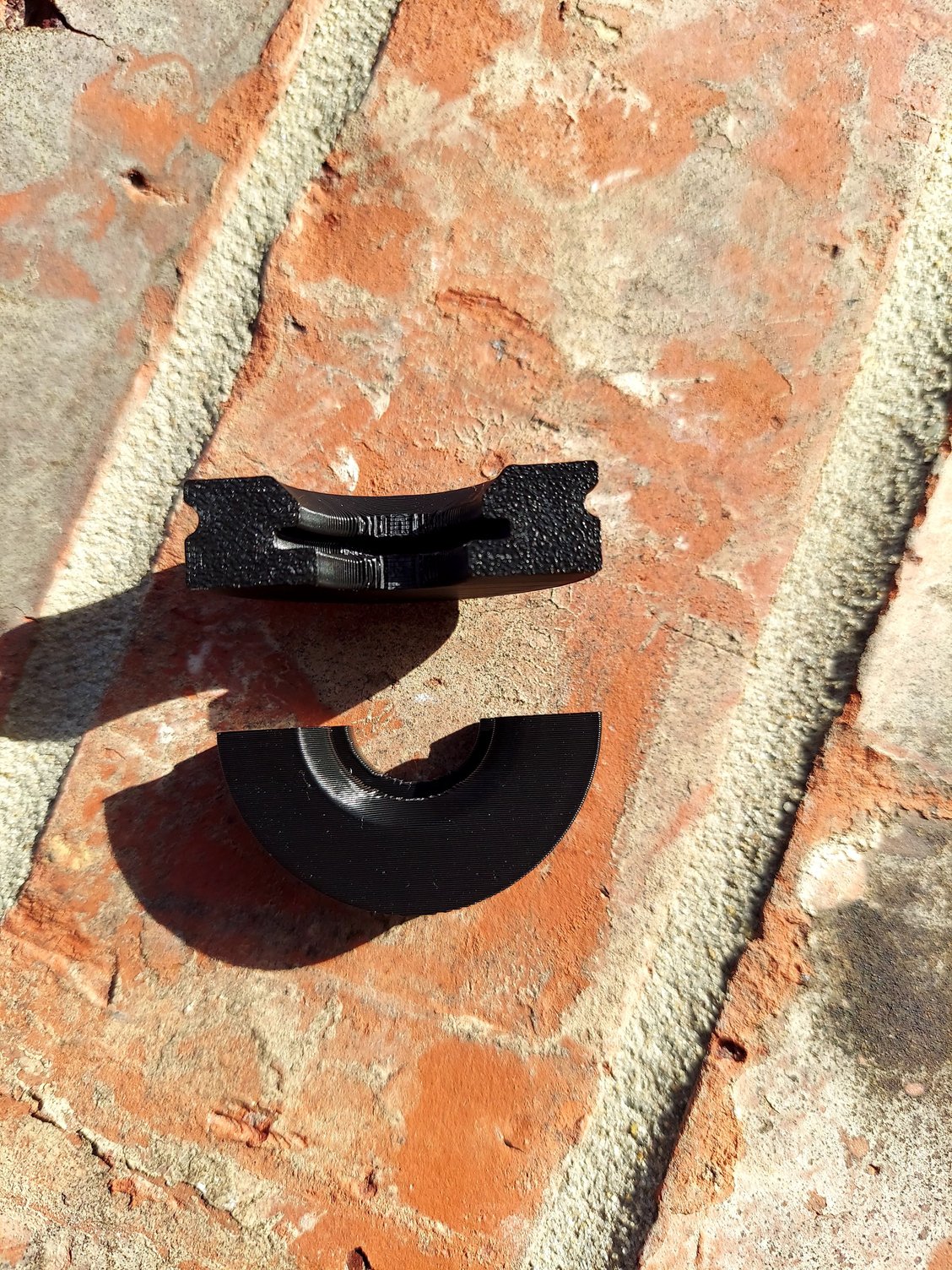

Finally got around to finishing the install, got the adapters modeled and printed
adapters
adapter half installed
both half's installed
boot pulled over and attached with tie-wrap, the boot has a bead on the interior to fit in the groove of the adapter.
