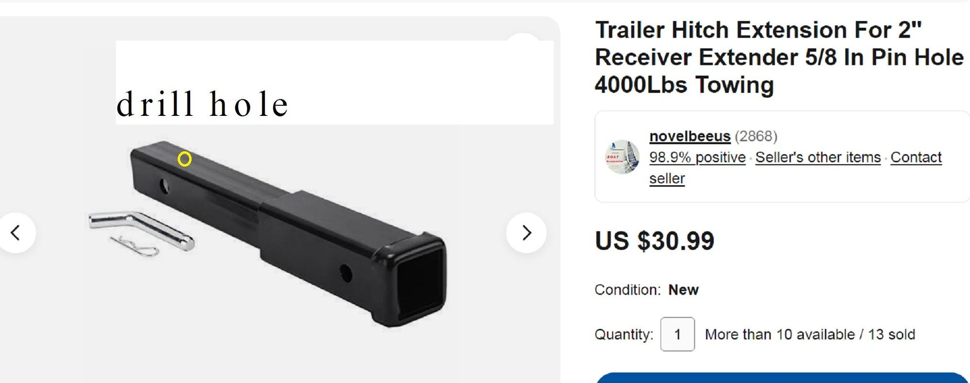

Old Feb 14, 2024 | 08:44 PM
HandsomeSteve's Avatar
Joined: Aug 2023
Posts: 108
Originally Posted by MixManSC
That being said, you can get aftermarket extension tubes on eBay for about $20 but you just have to drill the second set of holes yourself on the cheaper ones.
Here is the cheap on on eBay
8" Hitch Extension Receiver Extender 2" Reciever Tube 5/8" Pin Hole FREE SHIPNG! | eBay
Just have to drill the second set of holes yourself.
hows this look
can substitute the correct pin w/ a old tire iron? just want to move the vessel around in back yard. thanks
Old Feb 15, 2024 | 09:50 AM
Originally Posted by HandsomeSteve
hows this look
Hows about NOT DIGGING UP OLD Threads? How about avoiding that from here out. You tacked on the end of a thread from 2017, that is nearly SEVEN YEARS AGO!
