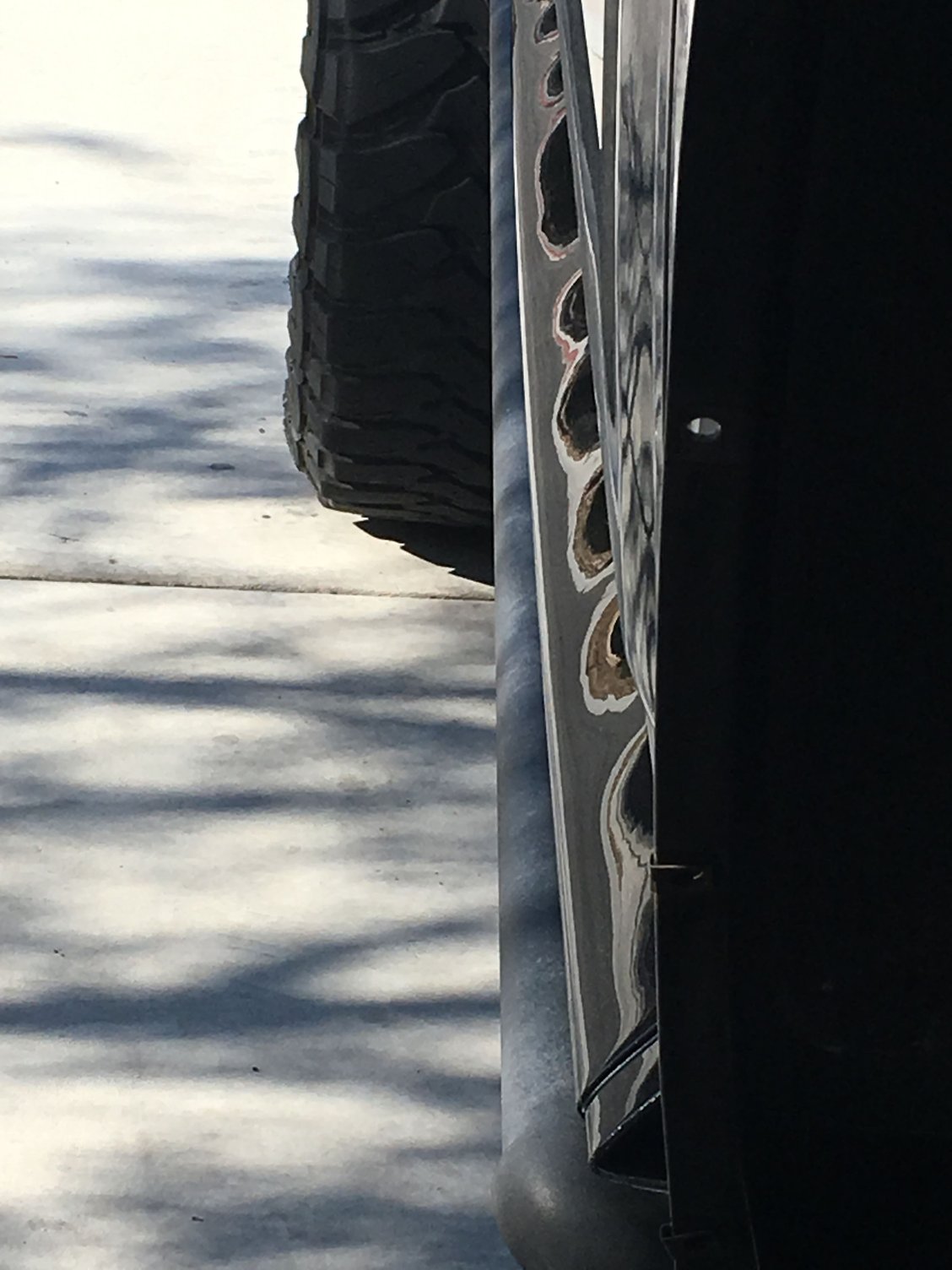

maxjeep, do you think the Amp steps could be installed with the OEM rocker guard still in place?
Not the big side steps but the small guard up against the body. I'm torn between the Amp steps and the big steps that come on the H2. I want the protection of the big steps for when someone swings a door open, but I like the Amp steps.

The AMP steps were on it when I purchased it. I really don’t like how far down the other steps hang down and taking them off is like adding a 4” lift. The amp steps are there when you need them and tucked away when you don’t and after having them I will never have another lifted vehicle without them. I don’t think you have room for both maybe I will get a pic and then you can decide.you have 3/8” between step and plastic. Steps do stick out a past body.

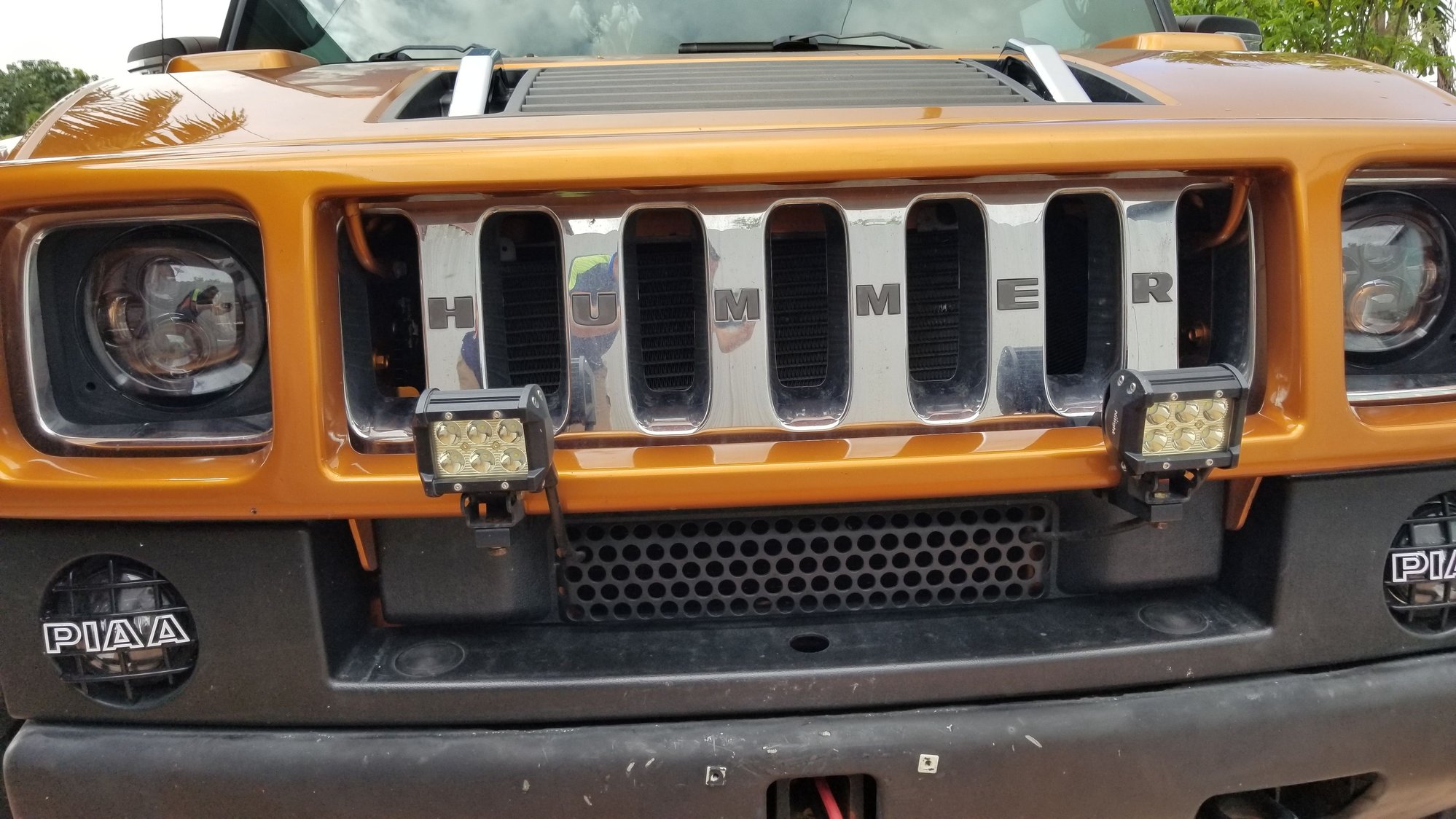

Now you are working with the headlights why don't too replace those ugly old yellow lights
Amazon have a bunch of Led to choose from . Any 7" will work with little mod of the housing
I replaced mine and the look changed 100%for better and the light output is amazing compared to the Oem

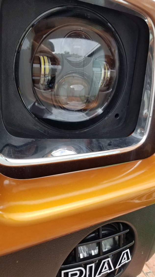

that picture does make them look yellow, they are not yellow and I did replace the bulbs with some really nice bright white leds.

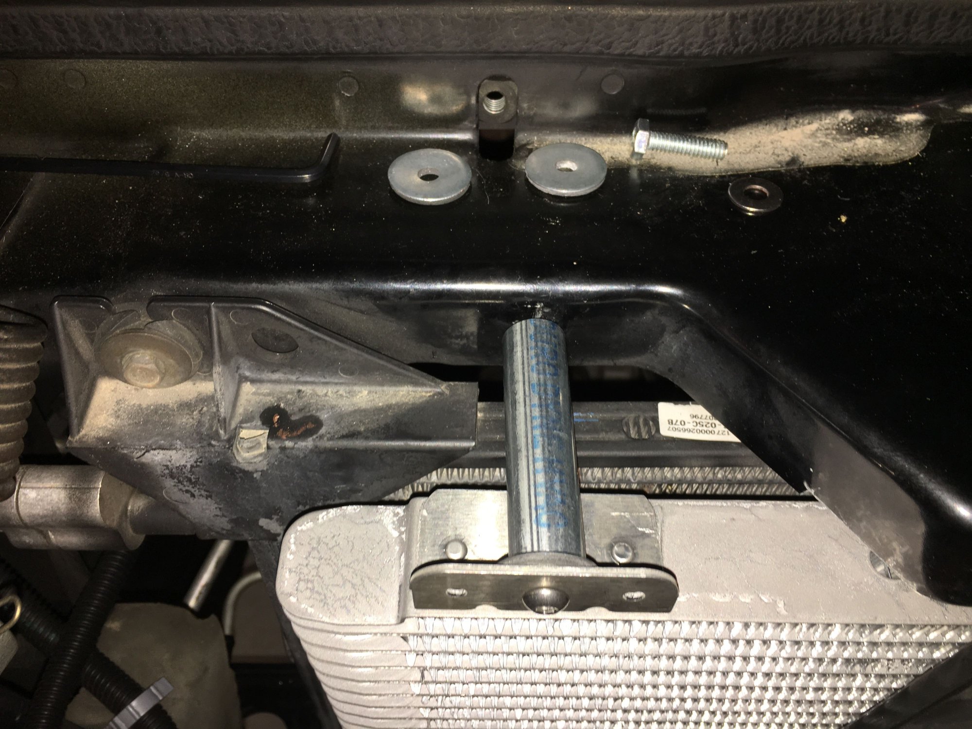

I used 1/2” emt and conduit locks that use a 1/4 x 20 bolt. It’s like a nut insert that we use for ductwork stiffeners on medium pressure systems.
My butchered cooler. Hahaha
I figured out how to mount the cooler and I really wish I would have got one 6” shorter. I moved the power steering over a little over an inch. I didn’t really have any idea how I was going to move it so I cut the brackets off and built back to them. I still need to mount the passenger side support when I take it back off. I still haven’t made up my mind if I going to use the Be Cool transmission cooler in the radiator or if I’m going to bypass it like most have done. I need my radiator before I can figure out how I am going to plumb it. Power steering cooler was a bitch but it turned out ok.

Sorry I wasn't referring to your lights but the light output from the oem bulbs . The Led bulbs will make a difference but believe me once you replace the headlight you wont regret . the dark housing will match better with your truckeliminating the chrome on the old oem lights .
