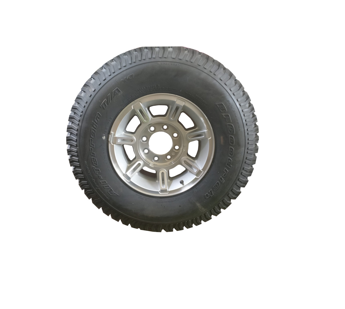

For standard alloy, i.e.

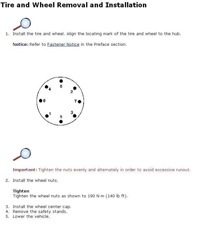

From the GM Service Manual I have:-
Ordinarily I'd stick with the manual, however I've seen figures of 90-100 ft.lbs but I've just been questioned on this.
Please could someone confirm what the torque settings should be for a standard alloy rim?
Thanks guys...

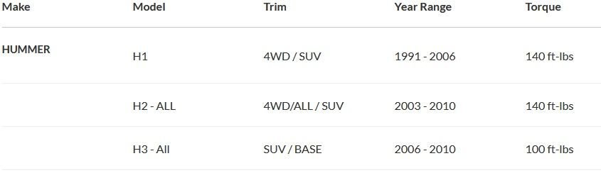

Old Nov 8, 2021 | 05:17 PM
oceanbrave's Avatar
Joined: Feb 2015
Posts: 1,635
From: Birmingham (UK)
Thanks hummerz
Indeed I've seen that same list (sparkyexpress?) anyway I trust your judgement, 140 it is

140 ft-lb is spec'd in the manual.
In practice, once that corrosion sets in, that 140 turns into a seized 200 ft-lb in the blink of an eye.
And wheel locks get rounded-off and ruined.
Torquing to 110 lb is plenty in my experience. Never seen one loosen at that spec.
When I torque to 140 lb, I crack the nuts yearly to avoid seizing.

Posts: 9,017
All the shops have to torque to mfg spec.!!!, many include a 2 pass on ALL wheels, or possibly get sued. DIY, torque you decide, is on you!

BS! Only torque to spec! My 3 calls for 100, yet I take them to 110-120, and they always take less torque to remove. Loose lug nuts=lose wheel!
