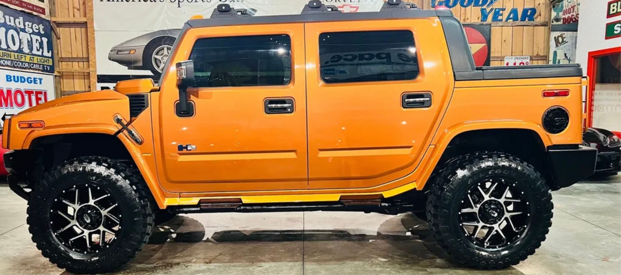

Default May have found it
Clean, clean under is as nice as the top. Inside is in good to great shape. I know and understand the cheap materials used in the interior by GM can not hold up great to any use. This is one of the better looking inside definitely the best under I a
have seen. All in pictures, so headed down tomorrow to look at it and hopefully drive her back.
a 2006 Fusion Orange a special limited run color. I lost it when I found it, orange is my color. Had to stop and take emotion out - ask wife and another buddy to look at pictures and give me their thoughts. A little pricey but within reason of the other nice ones I have found.
fingers crossed.

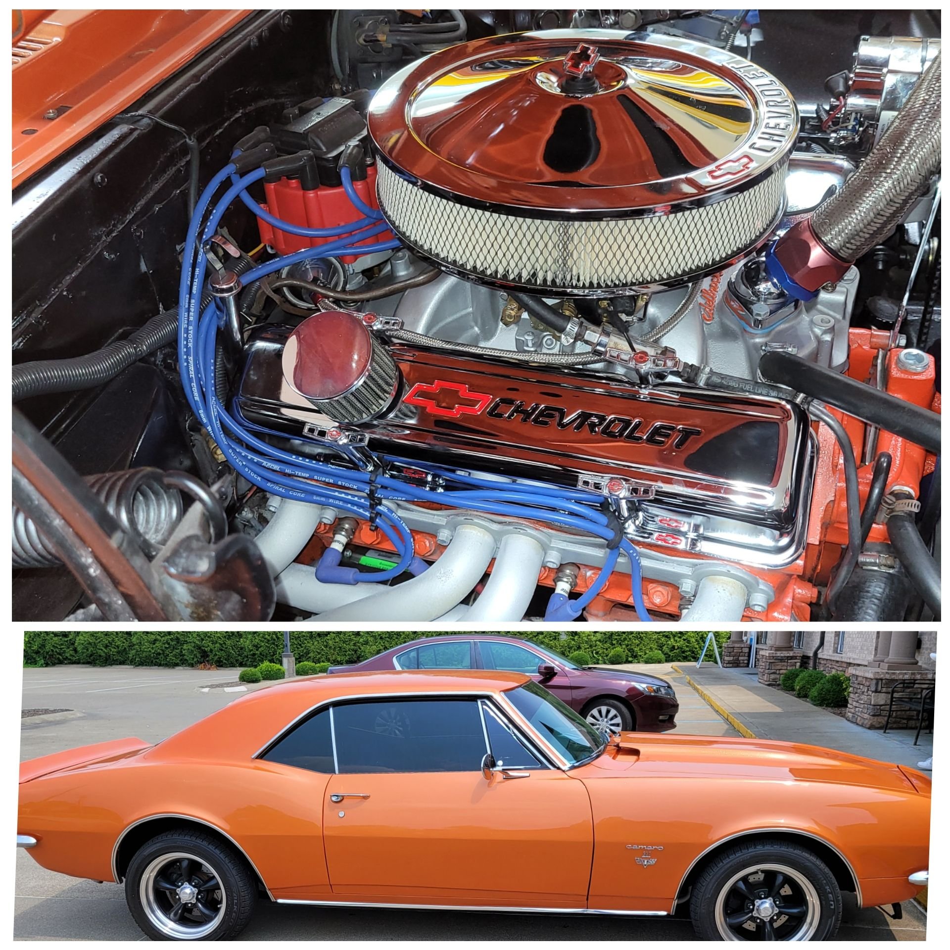

PS. Here is my baby- A 67 Camaro that brought back from the trash. Lol. One of a kind orange paint with ghost stripes that show up in bright light.
Old Sep 13, 2022 | 10:38 AM
H1H2's Avatar
Joined: Apr 2011
Posts: 43
From: Outside Philadelphia
both look AMAZING!!
