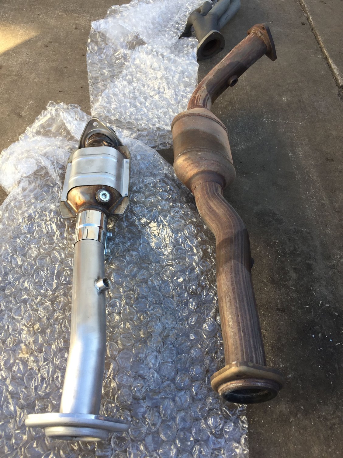

So, I finally bought some long tube headers and high flow cats.
Many years ago, I purchased some JBA shorty headers because my stock manifolds were very rusted and I had several bolts that had broken off at the head. I got a smoking deal on some “titanium, ceramic coated” shorty headers and bought them. I couldn’t afford long-tubes, so, I just went for the shorty headers.

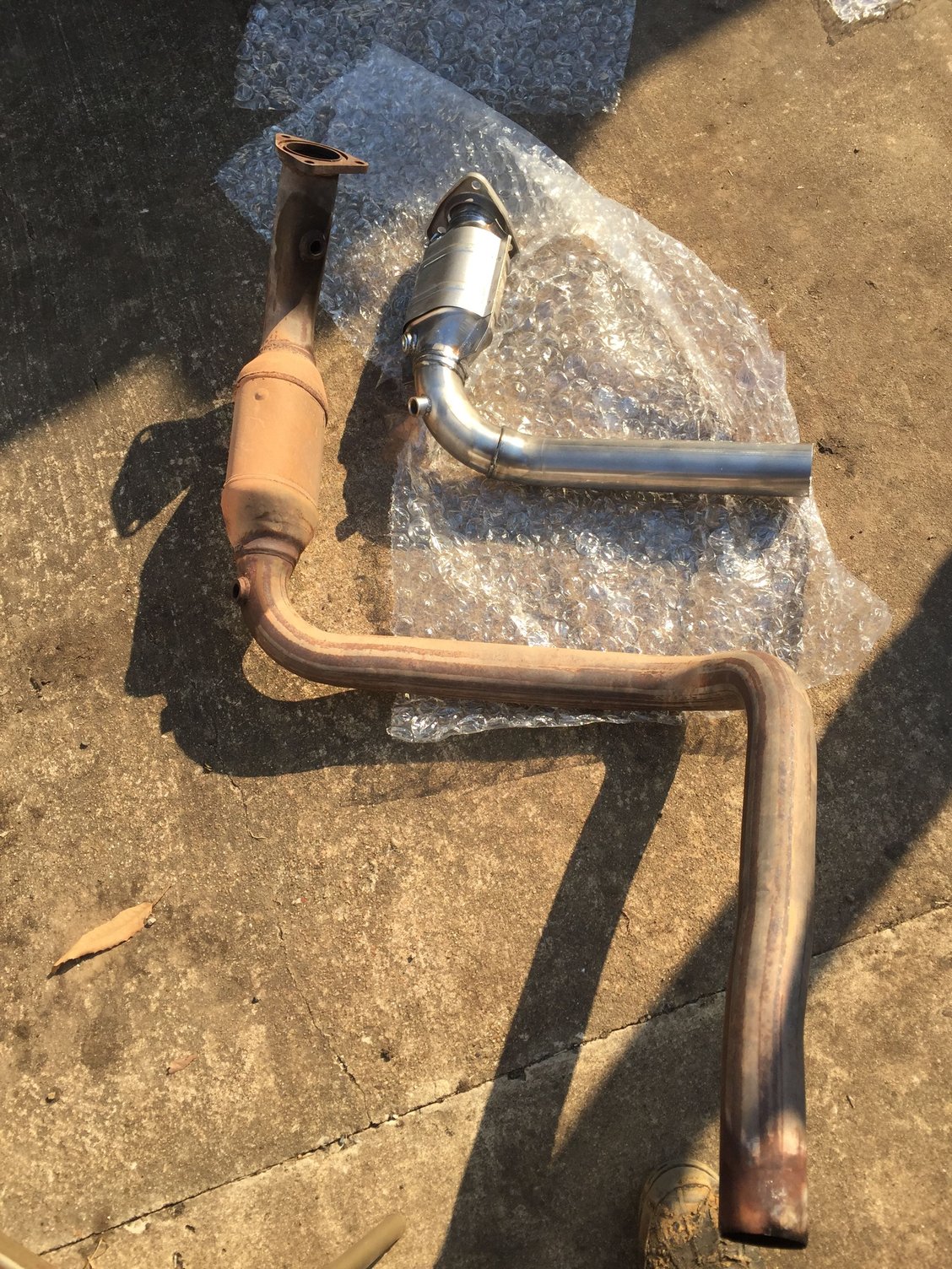

Fast forward to “sometime in 2020” and I started hearing a loud banging/rattling/quasi-dinging metal on metal sound. It would come and go. I made a few feeble attempts to figure it out and nothing.
Well, about a month ago I started up the H2 and the sound was very pronounced and consistent. No longer a random, or intermittent type thing. So, i devoted an afternoon to figuring out the source of the noise.
Turns out, my passenger side cat was broken. The interior guts had cracked and were rattling all sorts of crazy!
After some substantial research on catalytic converters and their cost, I began to consider some long tube headers WITH catalytic converters.

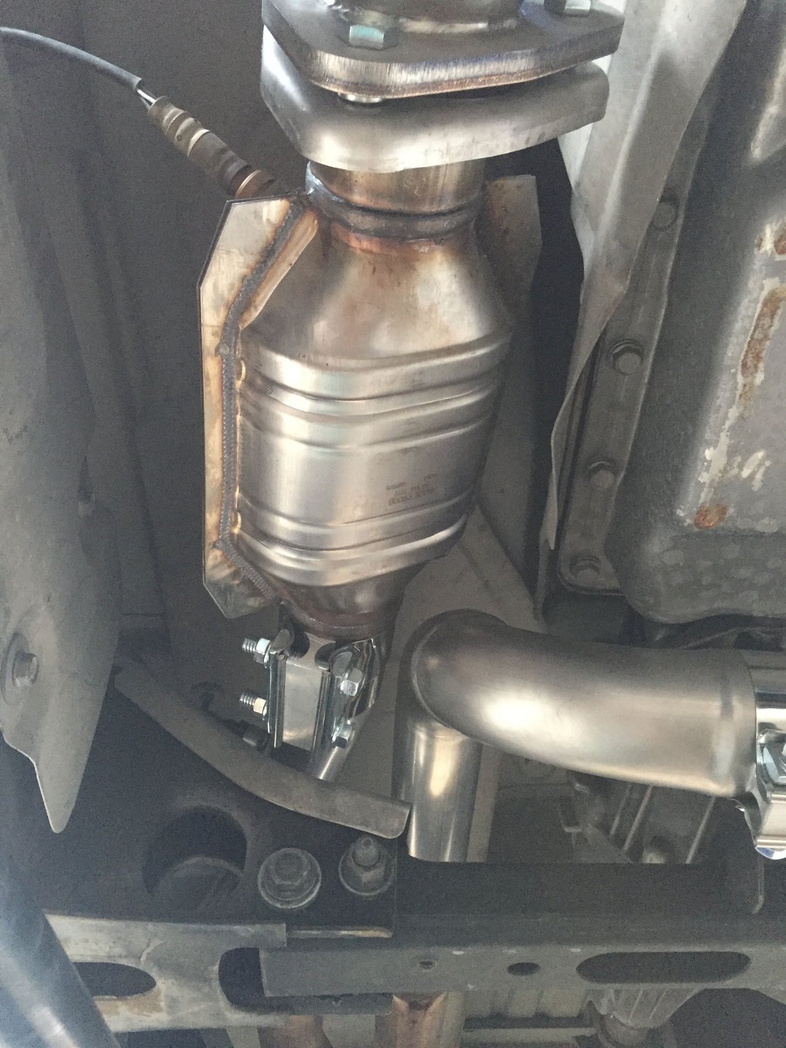

I purchased a set made by Dynatech. A set of headers along with matching high flow cats. Their cats only mount up to their own long tube headers. All stainless and with the O2 sensor bungs to maintain some degree of factory setup.

I went with a lower end brand and got the stainless OBX long tubes with high flow cats. Those connect to a full stainless GMPP (GM Performance Parts - made by Borla) cat back touring setup. Yeah, it made a significant and noticeable difference and sounds great. I did keep the stock airbox and filter as they are already a top notch cold air intake setup from the factory but I did change out the air tube for an Airaid tube. Then I did a custom tune, I did one for running 93 octane for about a year which was pretty sweet but the fuel costs got to be a bit much so I cut the timing back a few degrees so I could run 87 octane again without knocking and still very very happy with the performance although the drop from the tighter timings and 93 octane was noticeable. Prior to those I did replace the plugs with new ACDelco iridium, new wires, new knock sensors, and cleaned the MAF. When I got it I also changed it up to Amsoil synthetic oil.
Also of note - the OBX high flow cats are not terribly effective. The exhaust is a bit smelly and l got a check engine code so I had to reduce the downstream O2 sensor ratios in the tune (not a big deal for me since I have a full EFILive which lets me tweak things as much as I want). I have a 2" lift and run 37x13.5 (Cooper STT Pro mud tires) and currently have been running them at about 44psi. I need to do a patch test to get my ideal pressure though. I'm sure higher would help economy a bit but at the expense of ride quality and of course the contact patch is really what will determine the ideal pressure be it higher or lower. Prior to the tuneup and exhaust I was averaging around 9.8mpg and now overall average around town about 11.2mpg so yeah I did get a bit of a boost in economy. I attribute that to all of the work though, not just the exhaust.

My guess is that your MPG/ Performance gains are from the new cats, I bet they flow more than the OEM cat and there is a good chance your original cats were plugged up. I bet it sounds really good with the new headers.
p.s. 60 PSI in your tires? I run 35
Dynatech cats have 349cfm of flow vs stock has 257cfm.
I would have never imagined such a change in economy!

After reading some of the replies, sounds like the high flow cats are the main contributors to gains.
349cfm vs 257cfm stock, considering they were 16 years old and 1 was rattling, definitely a big change. This is one of the reasons i went for the long tubes....”i need to replace both cats anyway”
