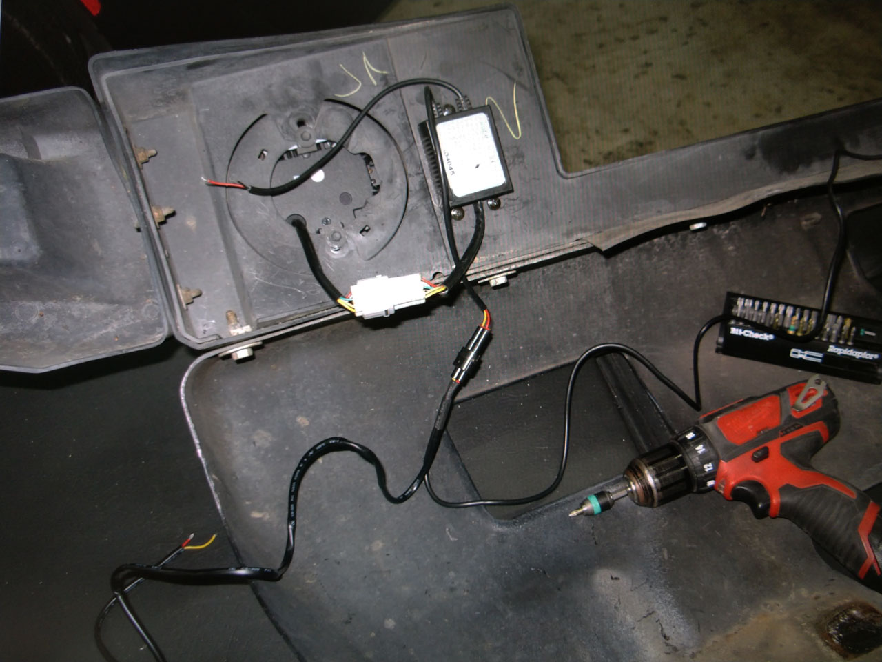

Oh wow! LOL - they obviously came here on these forums and took my exact idea and even stole one of my pictures!!! I am in some respects, flattered. For what its worth. I do think it is a good value if the brackets work. That was the longest part was figuring out some way to modify them so that I could mount them. They are also about the largest light I was able to find that would fit the pocket better as most aftermarket lights are only 4 inch which leaves a large gap around the edge. They also do work very well. The DRL rings are very bright though, at night you will get flashed of those are on. The driving light function is pretty darn good. They are no nearly as good as say, Diode Dynamics SS3 Pro's but they are not terrible by any means either.
So these are aftermarket lights for a Toyota Tundra. They simply went with my idea for using these and made their own bracket for them. I'm betting you will still need to correct plugs for the DRLs unless you want to cut the stock wires. In my original thread below I also detail how you can use a latching relay from Amazon along with a factory rear wiper/fog light button from a Tahoe/Yukon/Suburban to control the fog lights....
So here is my original thread for these from back in 2017. https://www.hummerforums.com/forum/h...-lights-39090/
And this post of mine from 2018 has the exact picture they stole and put in their Amazon listing. https://www.hummerforums.com/forum/h...45&postcount=3
In this pic you can see the same connection box and where I mounted it....
Attached Thumbnails LED Fog/DRL Daytime Running Lamps-img_20190314_151244535.jpg
