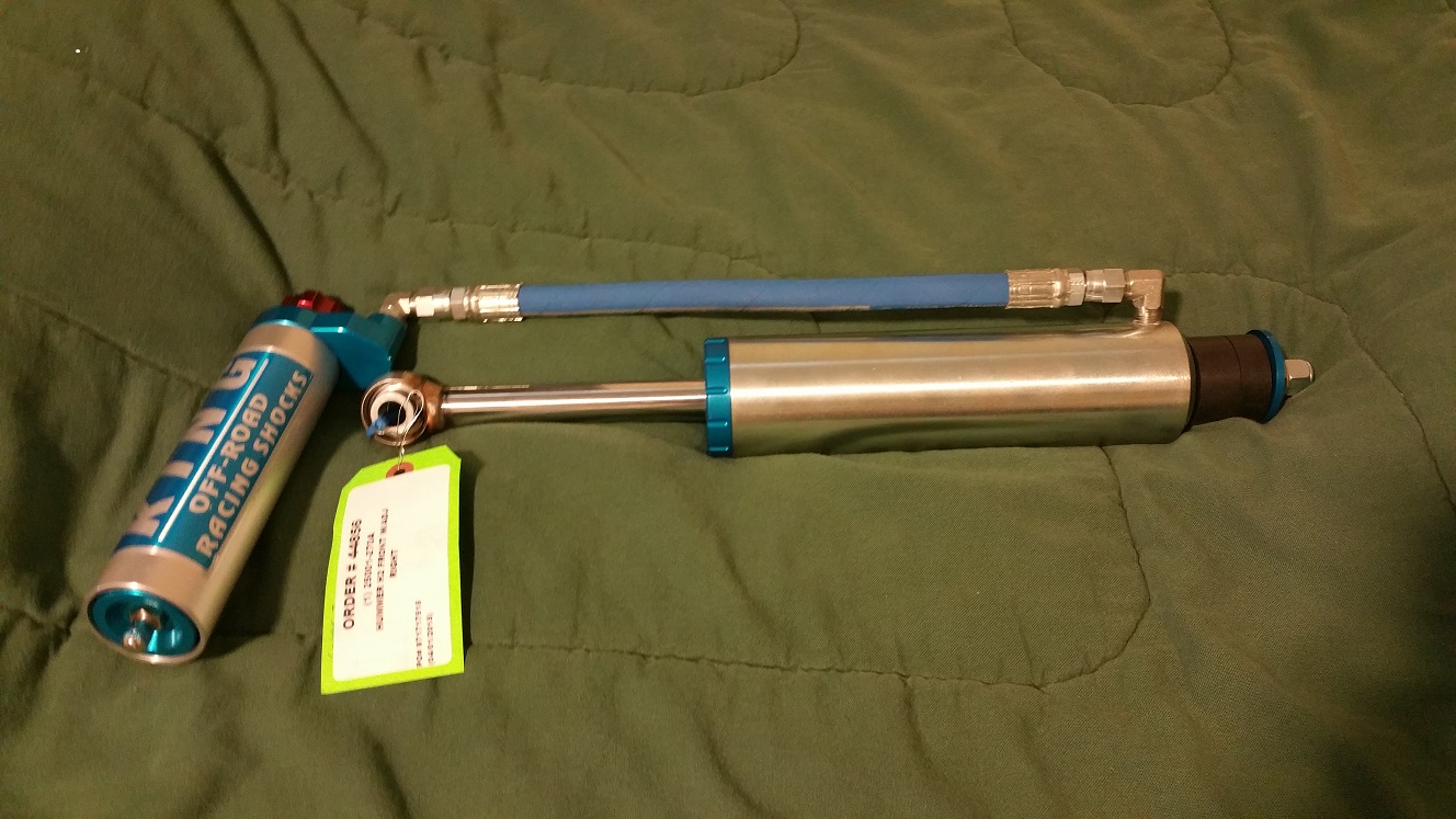

Here is the shock as it comes:

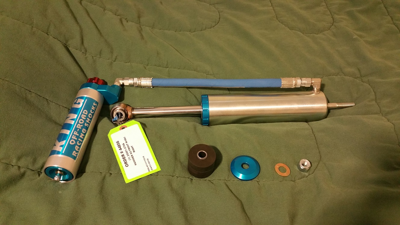

And here is the shock broken down to have it installed:
The shocks come standard with King's signature blue anodized accents. These look great. If you don't like blue, it will cost you $300ish per kit to change the color. That's highway robbery, but sometime to consider if you want a show truck.

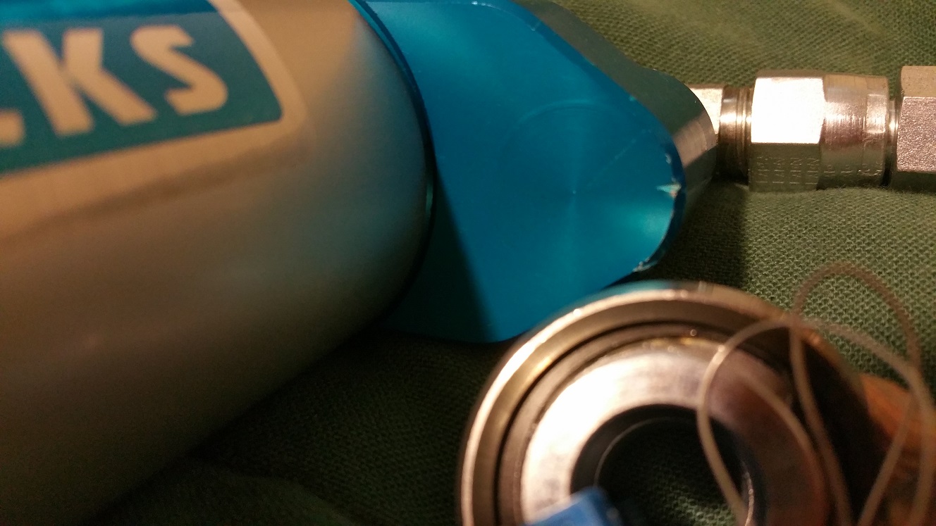

As for the quality, I'm a little disappointed.
Out of the box, there are scratches & dings on the anodized pieces. For a few hundred bucks, I'd be ok with that, but for an $1100 shock kit, that's not really acceptable. Treat your product better than this when in the building stage!
I realize these will get dings riding offroad & even on from rocks & debris. A product that is new should look new. Unfortunately, it seems quality across the board on many products is dropping, so maybe King is just cutting corners trying to move these shocks out asap.

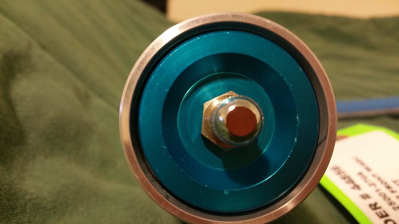

Here's two examples of imperfections & rough housing done to the shock, pre-shipment.

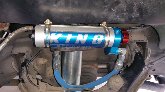

I'll be figuring out where to install the brace for the reservoir in the front. I'll probably bug you guys about it, so if anyone has ideas, let me know. I will post some pics of the rest of the packaging & content later.
