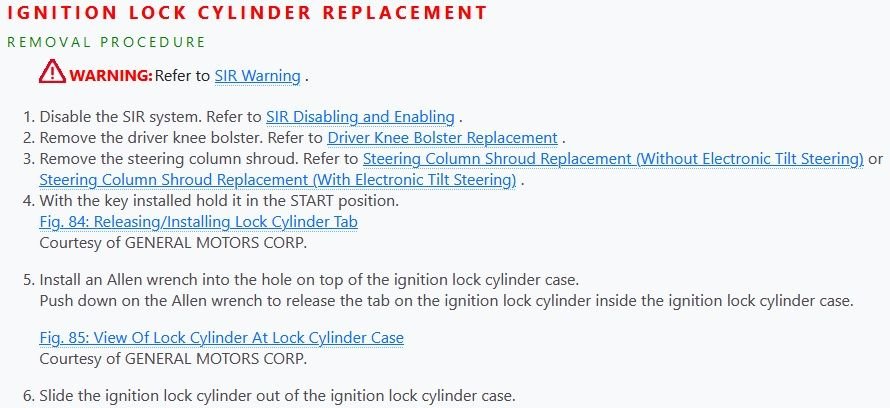

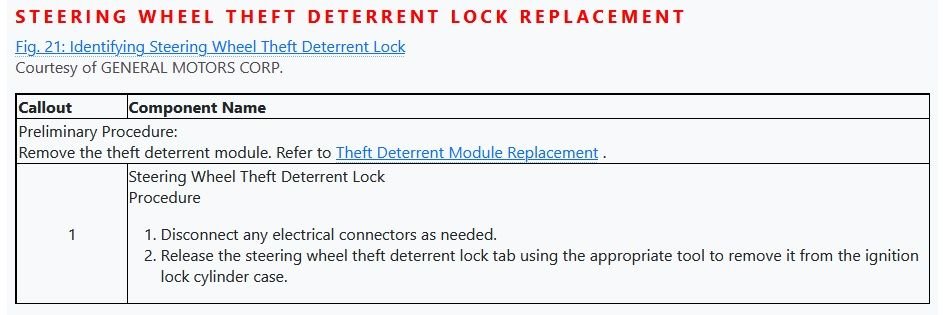

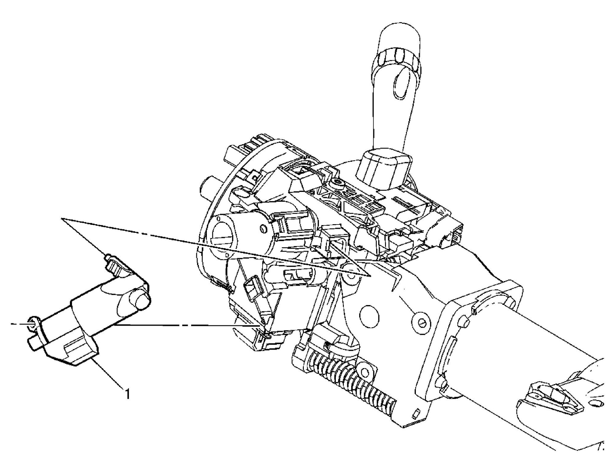

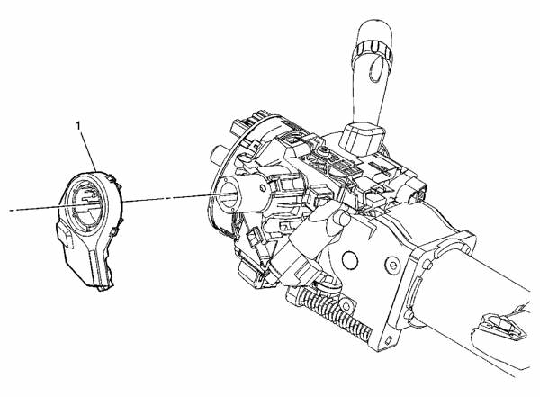

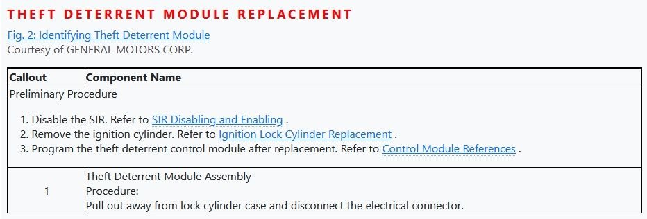

I called my local GMC dealer last week to ask about what would be the approx cost to have it replaced, after providing my VIN they called me back as said it would be a 3 hour labor charger if they didn't run into any problems and approx $100.00 for part number 26056147.
Considering they want 3 hours labor it must be a pain to change.
