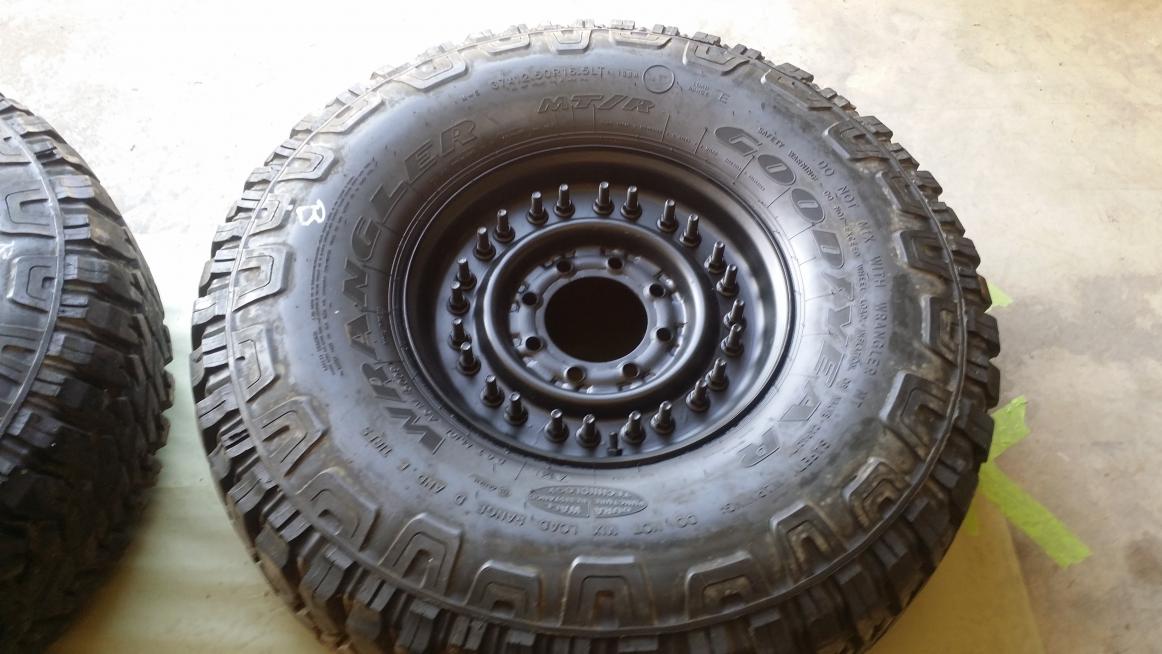

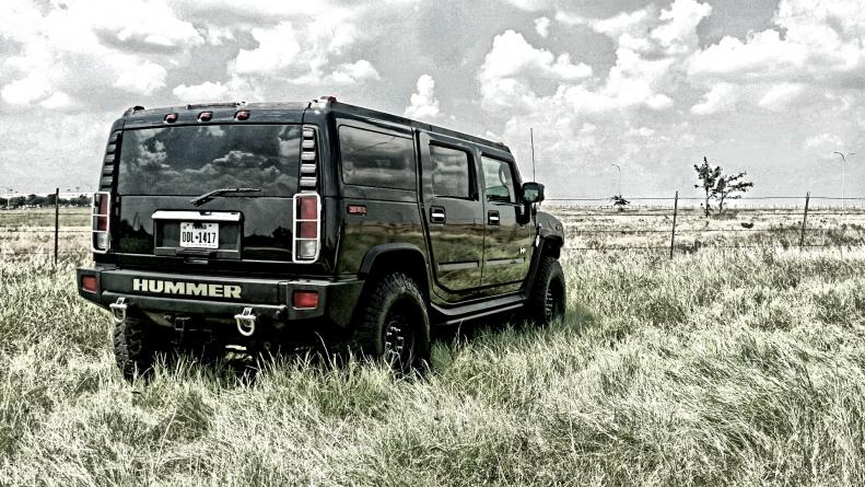

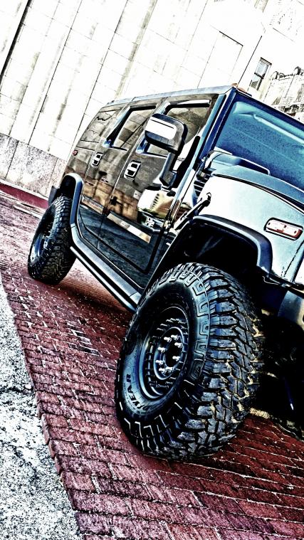

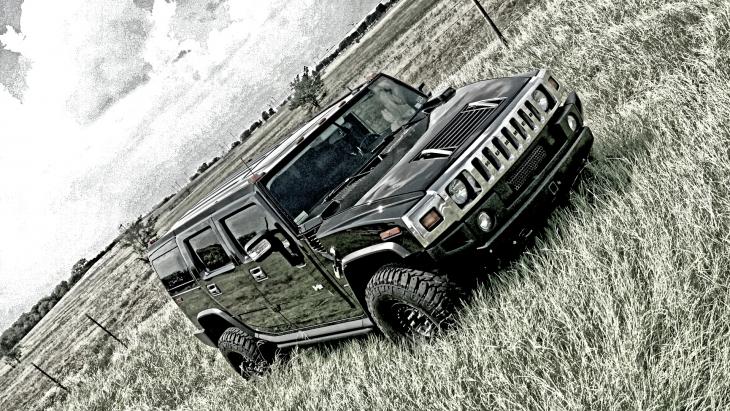

Wow love the look of your rig. Where did you find the H1 wheels? I might like those better than my rockstars. Do you have anymore photos? I found another photo of my rig from the summer
I got them from www.rallequip.com - (Goodyear MT/R 37X12.50R16.5 Tires + H1 24-Bolt Hummer Wheel 80-95%). Great guys to deal with and free shipping as well. The only thing I had to do when I got them was clean them up well and give a fresh coat of satin black paint as you need to remember these are Military DRMO surplus that have been sitting on pallets for awhile. The tire condition on mine was excellent with no issues.
The only word of caution I have is the following:
  • Mileage: I get 10.4 now as opposed to 11.1 prior, so not too bad
  • Weight: These wheels with run flat inserts and tires weigh 162 lbs as each. This will put a bit more strain on your drive line, hubs, control arms etc.
  • Maintenance: Once every 2 weeks check tire pressure to make sure the 2 piece wheels are not leaking air from the 24 bolts around the perimeter.
  • Usage: These are hard compound Kevlar lined tires that do great in large amounts of standing water etc. but will act up a bit more than normal street tires in extreme cold. Very durable, but you have to take a bit more care when on the highway as stopping distances increase by about 5% under threshold braking.
From my research you don't want the 8 or 12 bolt wheels - they aren't as strong as the 24 bolt wheels and are older in design. The 24 bolt wheels are safer to run on and off road and less prone to leaking air.
Lastly, you will need 2 or 2.5" spacers as the Humvee wheels do not have any backspacing and the H2's require it to clear the brakes etc. Don't go cheap on these (spacers that bolt to the hub which have lugs pressed into them to bolt the wheel onto) as they are critical in keeping everything together. Use locktite!
If you are considering going this route here are the costs involved:
  • Wheel/Tire package: $1,100
  • Spacers (billet aluminum w/pressed lugs): $350
  • Disassembly & resealing w/ balancing (just to be safe):$400 ($100/wheel at an industrial/semi truck shop)
The look is hard to beat, and ride quality is great with not that much road noise, but its a bit more work than just an off the shelf setup but totally worth it.
More pics as requested:
