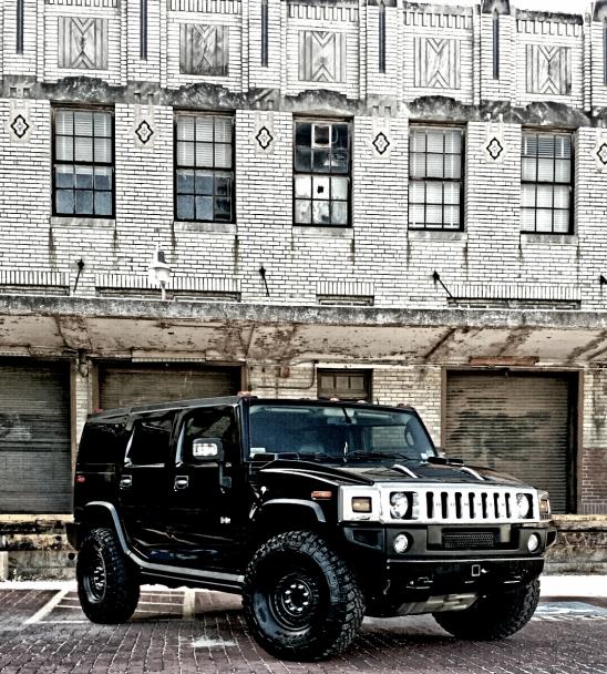

Hello everyone,
I currently have 35" toyo m/t tires with 20" rockstars (-24 offset I believe) on my H2 35/12.5LT20. This summer I was thinking of going with a leveling kit and adding Toyo M/T 37/12.5/LT20s. Im wondering what the pros and cons are going from 35's to 37's? Pictures?
Old picture of my HUMMER H2 but thats it with the 35's

Wow love the look of your rig. Where did you find the H1 wheels? I might like those better than my rockstars. Do you have anymore photos? I found another photo of my rig from the summer
