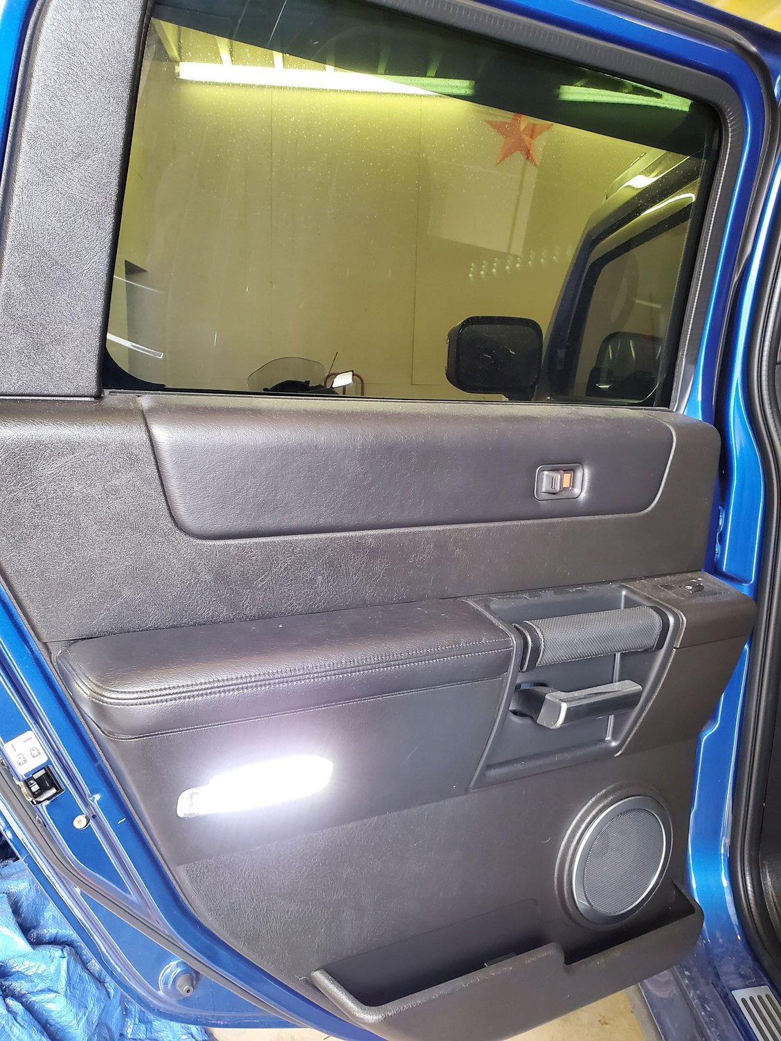

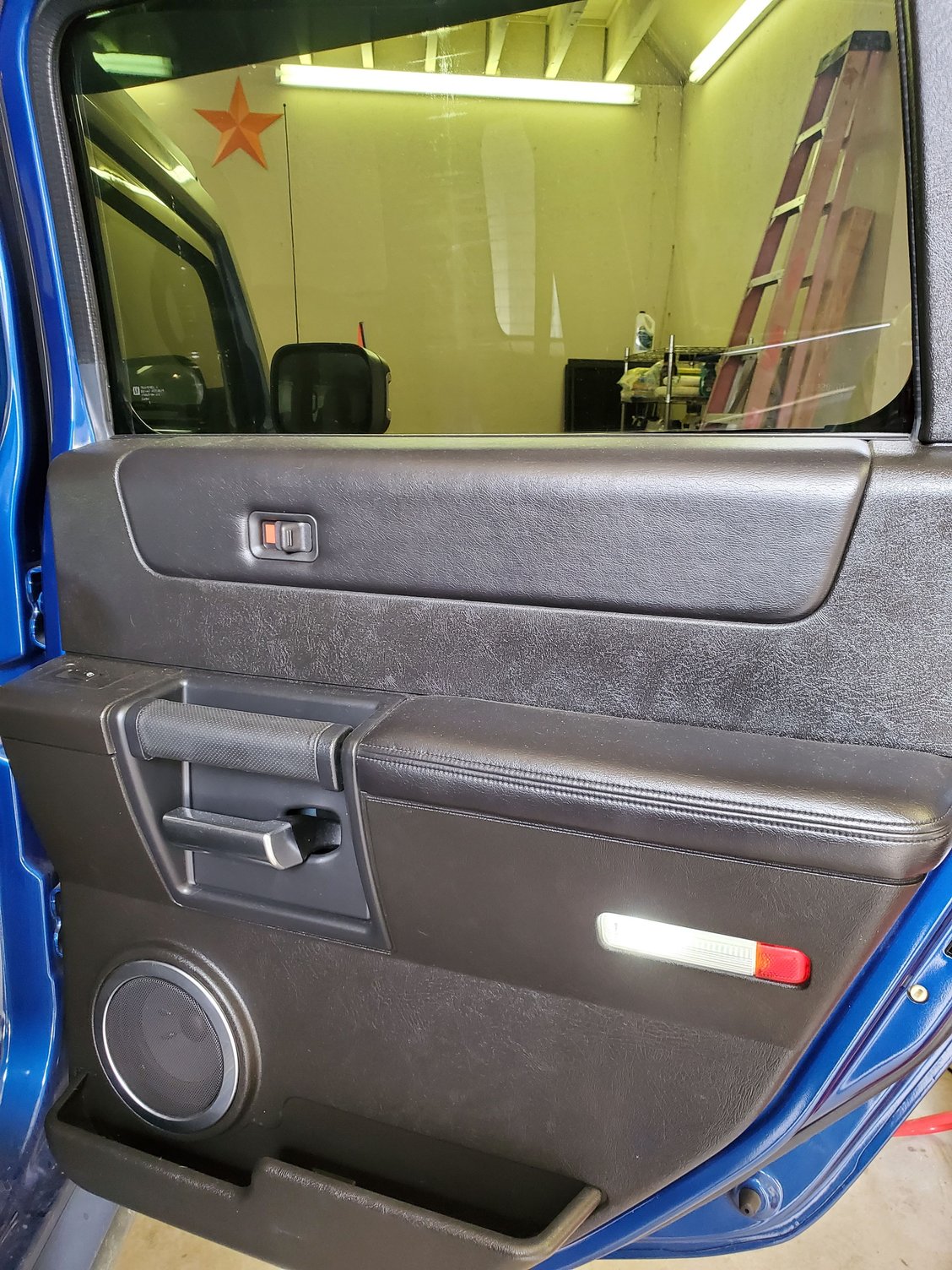

Well. I just wanted to make a post about the options out there now. My 2006 door lights are pretty dim and yellowish.
Yes, I did try the LED replacement blub when I had to change a window regulator.
But the better option is the full LED fixture... I think I paid under $40 for a set of 4 and they are kind of blinding.
I have no financial interest in the sales of anything here... just what I hope is some good advice.
Fitting new bulbs and having to grind open the hole to fit the new bulb is a waste of time.
Here are pics of all 3 options
Factory Bulb,
LED replacement bulb.
LED replacement fixture
Best!

Glad someone else brought it up. The new LED replacement courtesy lights are blinding. Even with a limo tint it looks like full daylight inside the truck at night. I may disconnect the fronts and cut the light in half

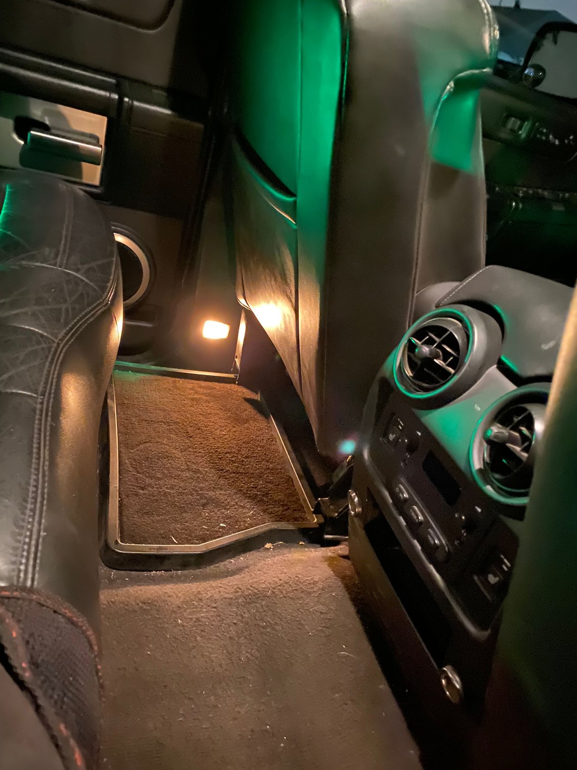

How do these open up for replacement?
Pillar post base lights

Do you have the part number for this light? I bought an H2 that does not have a cover on it and I can't find the correct part number or name for this light/lamp.
