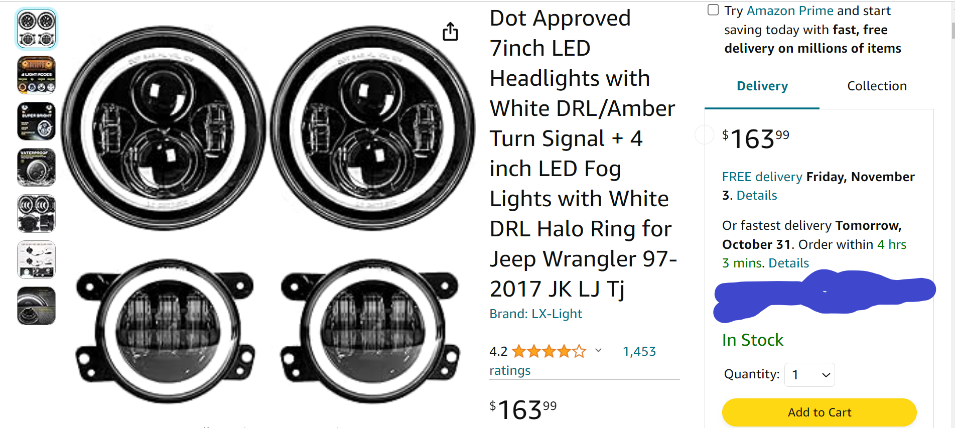

Anyone tried a kit for a Jeep similar to this?
Sure there are many brands similar
not affiliate link not affiliate link

I bought a similar set for my 06 but could never come to cutting the original headlamp buckets that was necessary to install them.

I installed these without any cutting or modifications required. Directly bolted right in.
Amazon Amazon
Did have to buy an adapter harness though as they didn't include one for the H2:
Amazon Amazon

I used that kit. cut the buckets enough to fit and enough left to go back to stock which will never happen. light output now is an amazing improvement, no relays needed just stock wiring with adapters and an added wire for halos to the DRL
