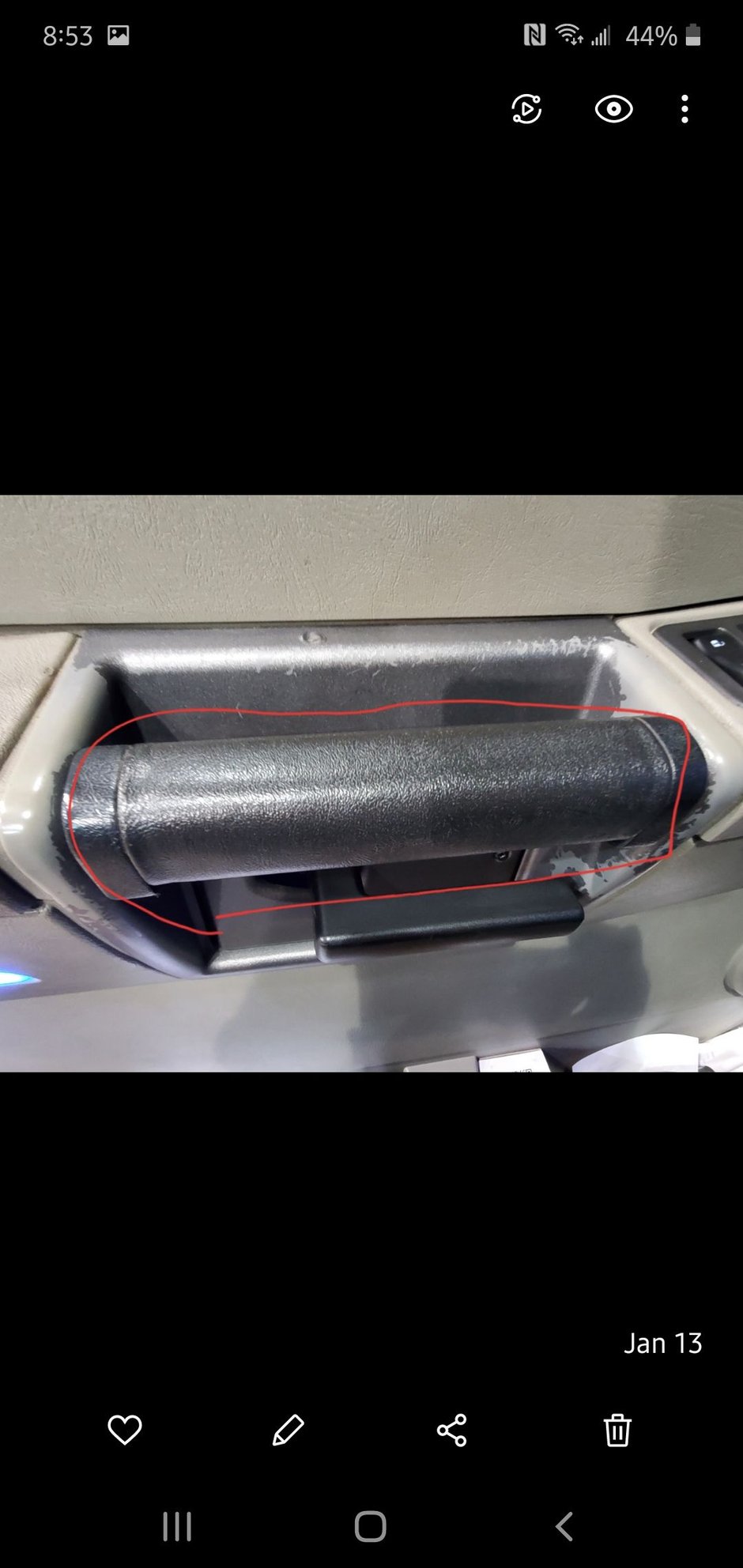

H2 door panel plastic blemish
Old Jan 15, 2020 | 10:07 AM
Posts: 3,207
one word of advice is. if you want consistent spray from a spray can only use 1/2 to 3/4 of it. once it starts sputtering it will drip paint instead of spray. i used a red scotch pad to buff the old trim and fanned out any spots that did not have a smooth transition from paint to chip. wash and degrease the panels before painting

I'm planning to cover the entire panel
But the only tough would be the door handle it's on my way when I spray do the spraying.
Old Jan 16, 2020 | 02:22 PM
The handle pocket bit can be removed from behind if the door panel is off....

I got the paint from lowes hoping to have a good weather this weekend it's been raining for the last few days.
I'm trying to stay away from taking off the door panel becasue it's so easy to damage the tabs from the panel
but I guess i really have to remove it to get a better job.
thanks
I'll post some pics when it's done.
Old Jan 17, 2020 | 08:25 AM
Yes be very careful removing the door panels. Ours are old and brittle and a used replacement front door panel in good shape is generally $500+ each....
Another thing I forgot about..... I'm not sure what year they changed it but on some early models the actual grab handle is not easily removable but I cannot personally confirm this.
You first remove the screw and the panel in the back of the handle pocket, then two 7mm screws in the metal bracket behind that. Then go around and release the plastic retainers. Ours use two piece retainers (one half stays on the actual door and the peg half stays on the door panel). Best to get a thin plastic wedge to get the edge of the panel out enough that you can then get a panel tool far enough in to pop it loose at the actual retainers.
I'd look on eBay for Hummer H2 door panel and look at some photos of the back of the door panels. That will make it easier to visualize exactly where the plastic retainers are making it easier to know right where to try and get to them to pop them loose.

Yeah the door panel tabs breaks so easily and yes for panel are not cheap 😟. There are few tabs that is broken on my back door panel lower section, I hate it because there is nothing you can do when the tab is broken and the panel is not secure and it vibrates
so what I did I put clear silicone underneath there panel around the outside only, and it works really well.
Anyway thanks for the info I'll work on them today.
